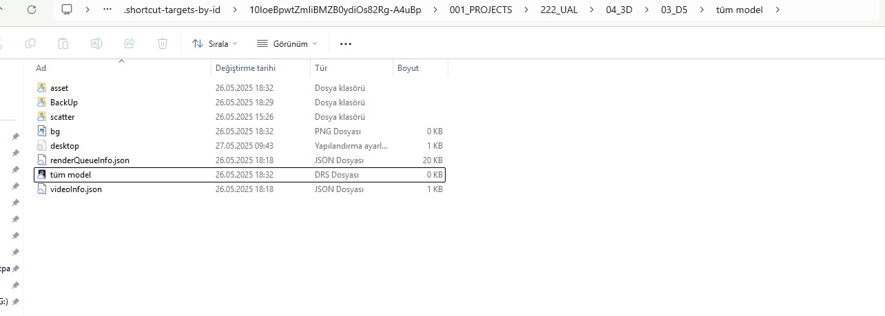

I’m receiving a ‘the project file is corrupted’ warning, and the files appear as 0 KB, as shown in the screenshot. I was working in sync with SketchUp, saved multiple times, and haven’t changed the location of any files. Additionally, the ‘View History’ button is not active, and Auto-Save is partially enabled. Can you please help urgently? If this happens again at a bad time, it will cause me serious trouble.
Hi @soistanbul
It seems that you have saved this file in your cloud storage based on the “cloud” icon that is beside the file icon. Please download everything (all files present in your D5 Folder) in your local storage path.
