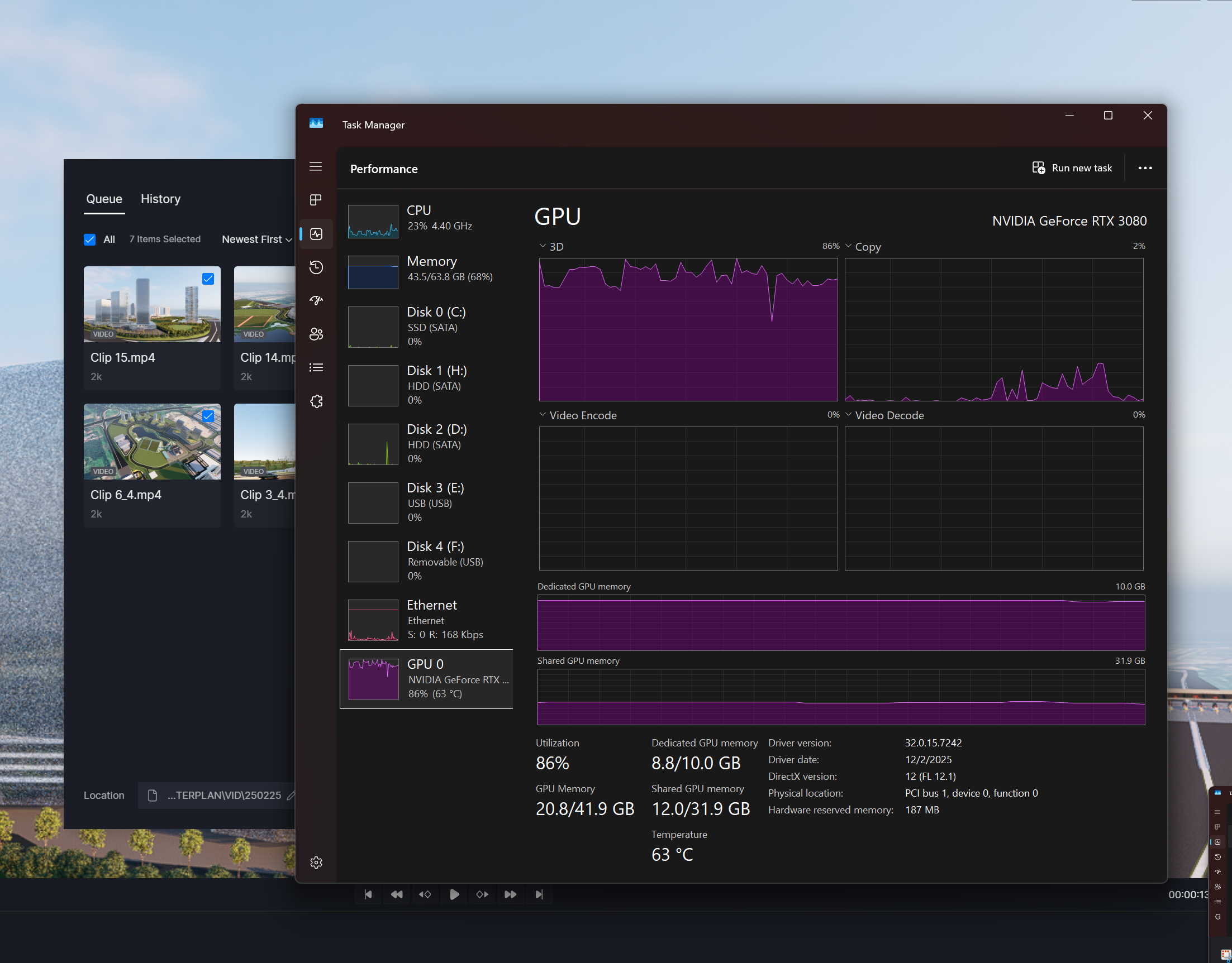

2)attach here is the screenshot of the task manager
  1. ok i will try on yhe clean reinstallation for GPU Driver. will share the feedback later
Hi @fawwazroti
Thank you for these images. As you can see, 86% GPU Utilization is quite high and considering that you only have a 10GB Dedicated GPU Memory.
It might be best to also optimize your scene file by:
  • Hiding Assets that are not seen in specific scenes. Grouping them and separating them by layer should help.
  • If it’s not needed, you can disable Path Tracing temporarily.
  • Run Smooth Mode when working with the file, you can restore it to Precise after.
  • Temporarily disable Dynamic Assets.
