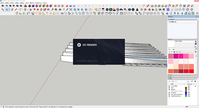

The sketchup file just a test with few contents, when I tried to click the icon “Connect to D5 render” it stucks at below windows.

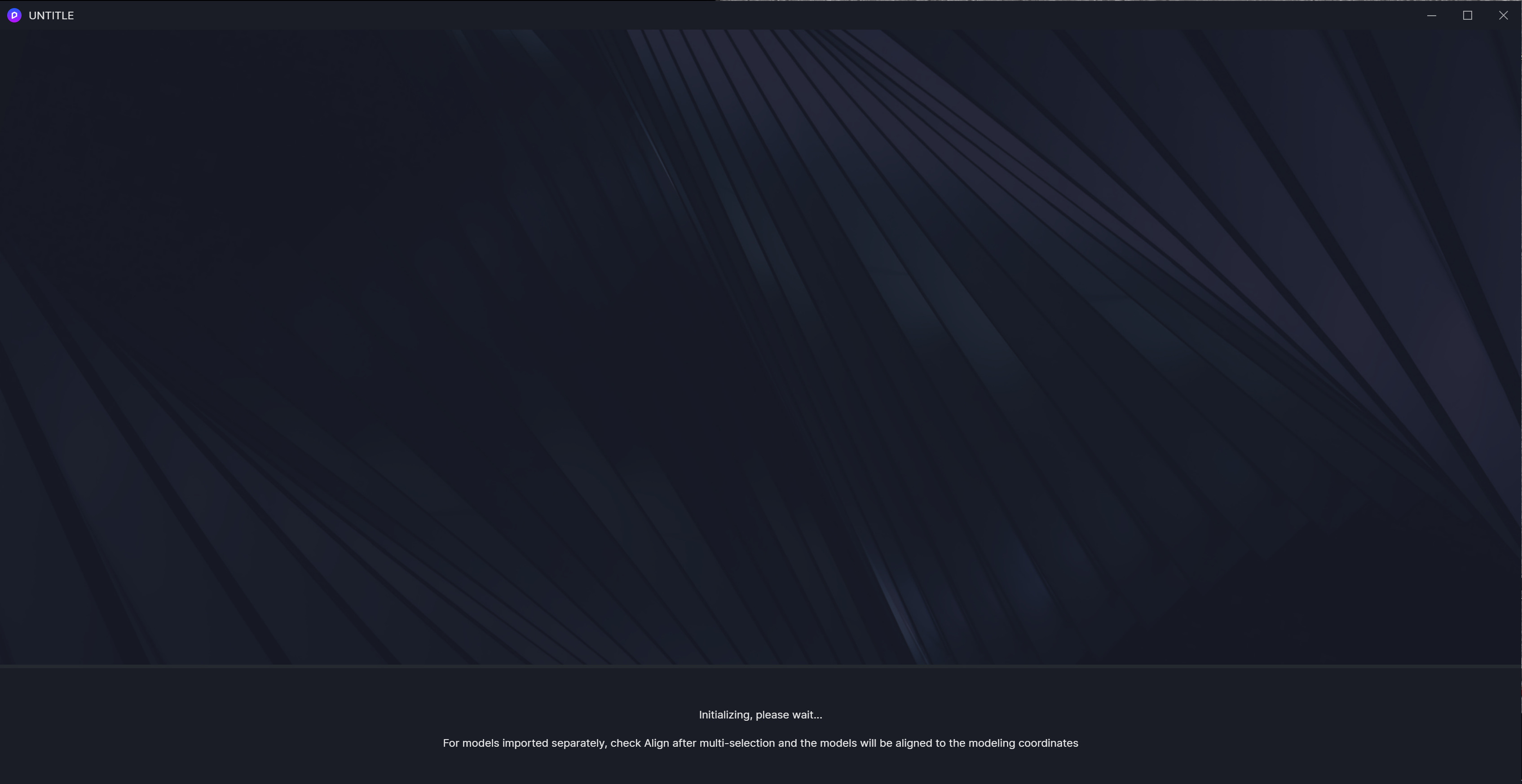

I try to open the file in D5 render, it keeps initialing as below.
Both ways I have keep waiting for 1 night more than 8 hrs, still loading.

Hello,
D5 persists in loading with no response if create a new empty scene.
