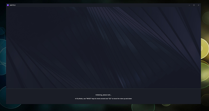

Fail initializing 2.5.2 version
cpu 13700kf
gpu 4080 version 31.0.15.2802
ram 64Gb
windows 10 pro version 22h2
When I try to start the program, it stays stopped on this screen, I have tried to install it several times and I can’t get this to change. I would need help. thank you so much.
hi,Due to the situation that “NVIDIA 531.14 and above graphics card drivers are not compatible with Windows 10 v1909 and below, which will cause D5 to get stuck”, D5 version 2.5 optimizes the limitation of hardware detection and restricts the system version of devices using 531 and later versions of drivers. D5 version 2.5 optimizes the limitations of hardware detection and restricts the system version of devices using driver versions after 531.
In this case, the minimum version of Windows is 10.0.19044 (win10 21H2).
So, you can try to upgrade the driver to the latest version, hope it can help you!
Thank you very much, I have updated the drivers and the problem has been solved.
