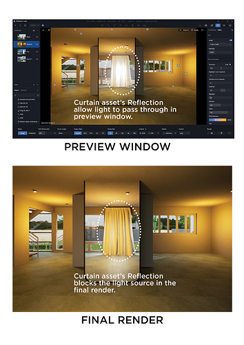

I really need help with something that’s driving me completely nuts. It’s about fabric materials not showing up right in the reflections. The weird thing is, in the viewport (non-rendered mode), they look fine, but when I render, they block the light. What could be going on?

I apologise for the inconvenience this issue has caused. I have tried to recreate it, and it seems that the light source is being reduced significantly compared to the preview window. I have reported this issue to my team and I will be updating you regarding it as soon as possible. Thank you so much for pointing this out.
OK thanks a lot! yep, tell me whenever if there is something you could do…

The Cloth/Sheer material of the Curtain Asset used in the scene is performing as expected. The light calculation in the final render is more accurate than in the preview window. If you prefer a light-transmitting curtain material, you may want to change the Cloth/Sheer settings. Thank you.
