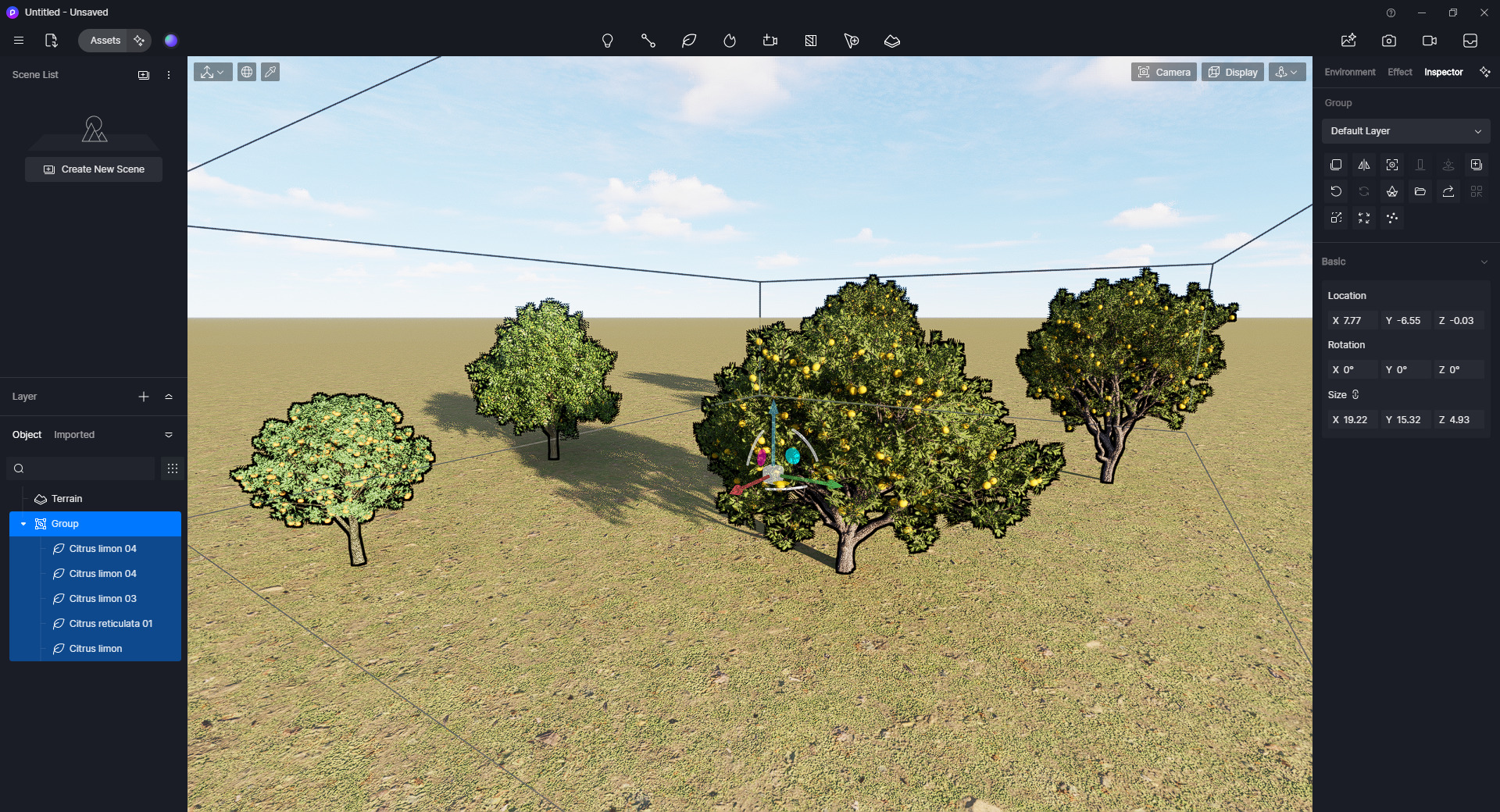

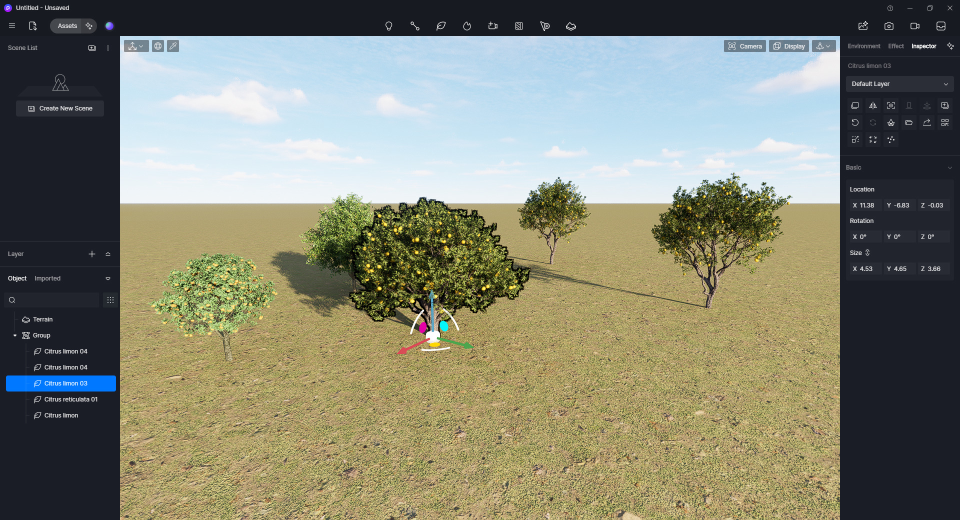

Hello everyone, then if one wants a group of plants, those preferred for your green extension, you can create a group of plants.
That you can modify it at will how to do with the lights, but this seems to me that D5 has created some types of garden plants, which is always groups that you can open in the group’s curtain and select it and move it.
If and this is the problem?
This is a group of “Citrus Limon” trees
You can move this as you want
If, on the other hand, you want to take only one tree, just enter the group that is on your left and select and move it
