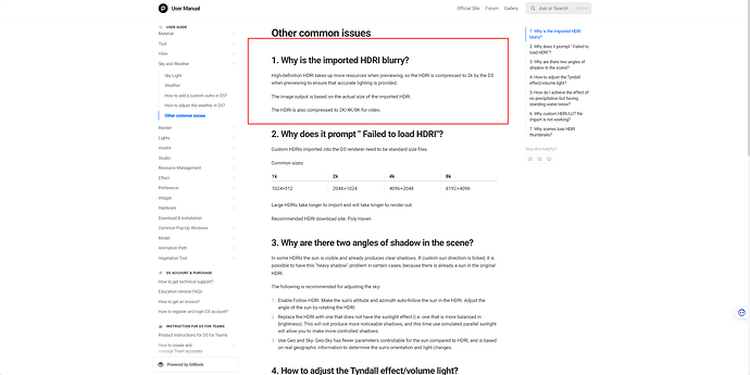

Am I setting the wrong settings in D5? Previously it wasn’t like this but now all HDR D5 and extras are still blurry when rendered

I checked your file. It’s a known issue. Currently if you use HD HDRI mapping in D5, the preview is blurry, but the render is clear.
