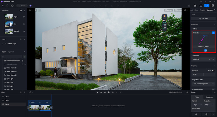

Hello, Ease in and out itself is an animation with an accelerated effect, are you finding any problems with the current animation? If possible you can use a video to better show your needs or suggestions.
Whats the best way to gradually ease out a video on the last key frame with out causing the video to accelerate beforehand?
Hi! I think you can adjust the curves of the effect yourself.
Hi, Yes i am adjusting the curve myself - the problem i find is that if i try a create a very gradual slow down it creates a speed up in the sequence prior.
Hi, Please note that it only becomes noticeable across 4 or 5 key frames/cameras ( not 2 as you have shown in the screen shot0
Really sorry for your issue. Could you please show us your video? It may be helpful for us to solve your problem.

Thanks for your feedback. I think that on the basis of the video I provided, perhaps if you set the time of the last frame to be longer (longer than the time of the last linear frame), it might help you achieve the effect you want.
Hi Luna,
Unfornately this does not achieve a gradual slow down to stationary- however i have managed to achieve the right effect with the below settings:
