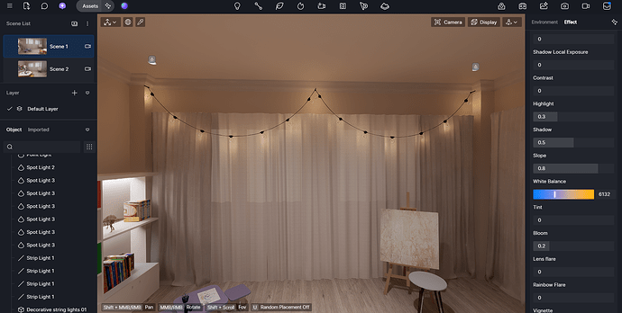

See my samples:
Screenshot 2024-07-25 104159
I have the same problem. I am using string light from D5 assets. but they have little light. not even visiable from far away. I dont want to add light individually one by one to each lamp since i am using a lot of amount of string lights. what could be the solution for this problem?

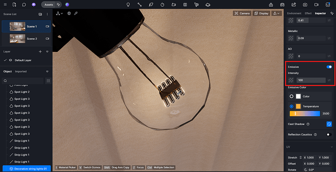

Hi @selindrella
You can try using the Material Picker ( i ) along with Alt to select the inner material of the string light, such as the bulbs, and adjust their emissive setting. Please note that the maximum emissive value is 100, which is the highest brightness currently available. Thanks :face_holding_back_tears:
