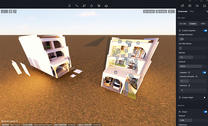

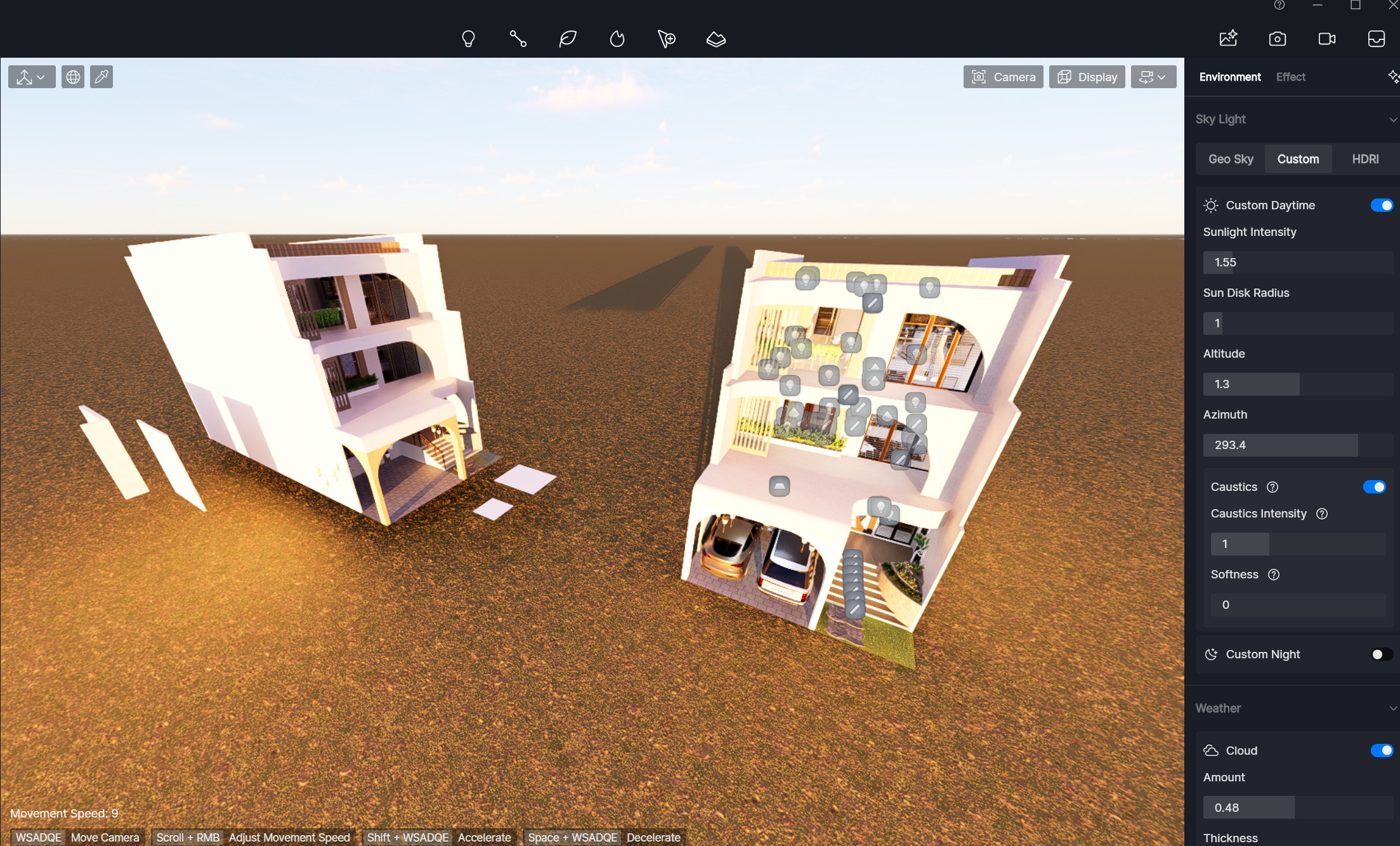

So I was unaware that changing the File Location or the Name of the file on either the Skp File or D5 File would mess up the Live Sync. Last time I asked i was told to click the “Replace an Existing one” option but when I did, it duplicated my Structure (one that is new one that had progress) and the Skp File that was synced was the blank one while my past version that had significant progress was not Synced. Is there a way to actually sync the House on Skp with the D5 House that had progress?

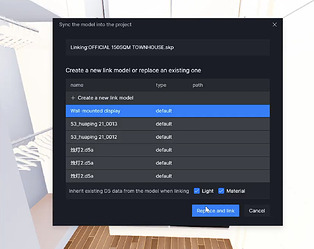

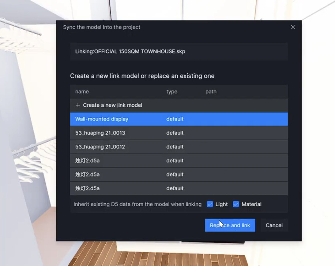

Hmmmm i dont think it occurs randomly it just happened after i click the “Replace an Existing one” and yes the files are located in one Local Folder but I am planning to put it in a physical hard drive. But heres a recording on how it occurs (its in a newly made google drive folder)

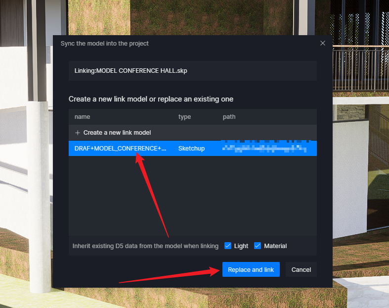

Based solely on the video recording you’ve sent, since you’ve selected an object apart from the 3d Model to be replaced, naturally, whatever that object was will be replaced.
  • I tried replacing the 3d Model with the same 3d Model but with a different name, it should retain the information as long as you click the model and proceed to “Replace and Link”
Hello!!! your tip has worked! i thank you so much!!!
