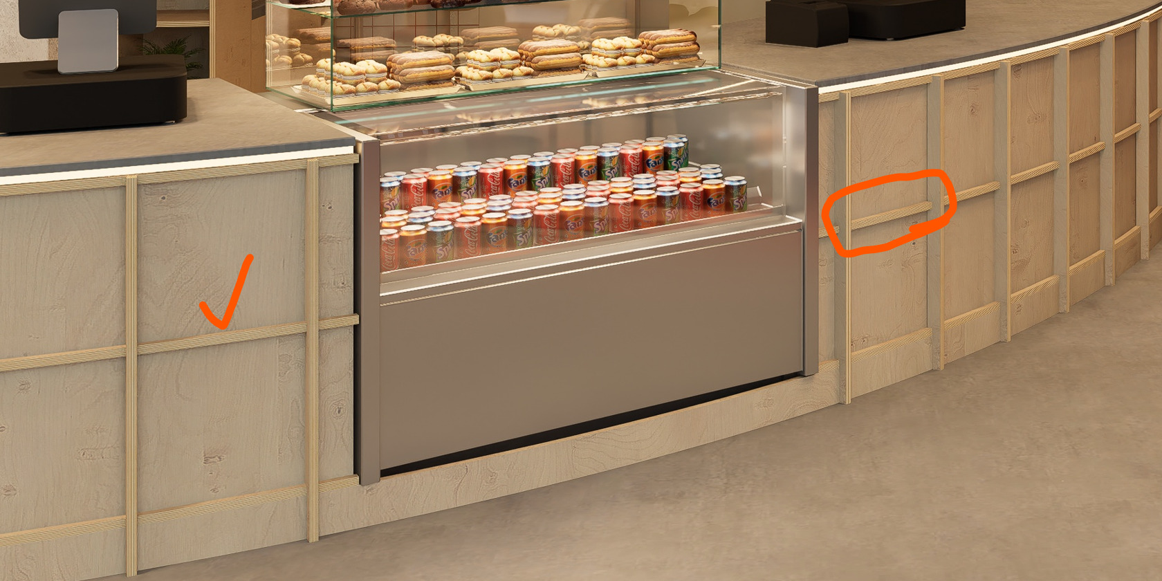

I’m experiencing a strange issue with rendering on my laptop. When I zoom in on rendered images, I notice deformed areas that shouldn’t be there.

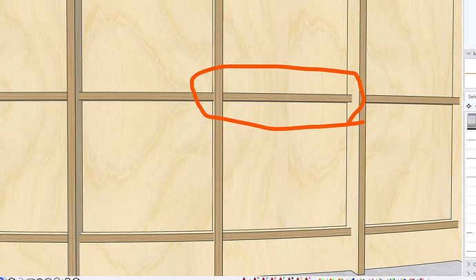

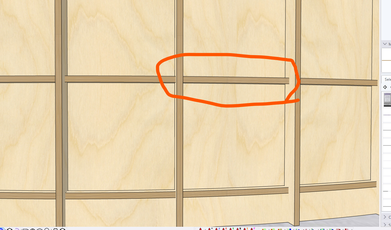

attached are zoom in cropped image the original image was rendered in 6K

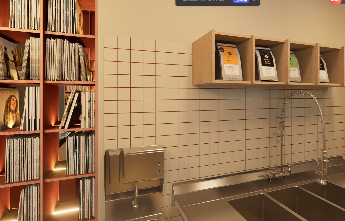

Hi, you can try to disable these functions when rendering.
one strange thing, when i logged out from my account and rendered the render became normal
logged in again same problem
i don’t have Ray Reconstruction at all
All turned off already
Is the SR image Rendering turned off?
it should be turned off to have more accurate details there
Menu>Prefrences>Widget
when you are not logged into D5 the PRO functions are disabled. As nima writes. DS SR is to be disabled in order not to have the error
It worked , thank a lot !!!

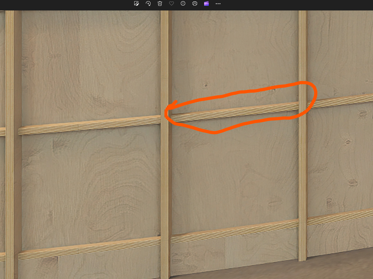

Now, I myself have the same issue, even when SR is off, and even when LOD is off - turned on custom setting and set to 2 - 2 - 100 - 0.5 - same issue
It should show horizental edges but keeps showing it curvy/slanted (not a texture issue)
it gets like this

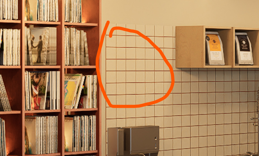

It clearly does this when the object is further away from the camera (which LOD off should take care of it)
I am missing the delivery today anyway, but it is good to know the issue for the rest of the projects
The images make me feel like when SR is turned on (although it is off and restarted)
These wavy tiles make me feel that
Still, the main problem is the texture on the plywood mentioned in the first post. Sending this image just to see if it helps

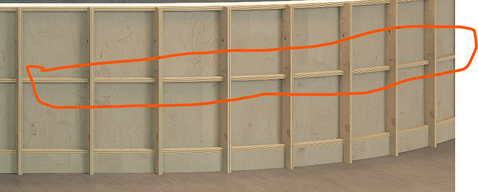

Well actually I do not expect to see it accurate in the preview since it is a very narrow parallel edge detail. But closer to the camera it shows very well, like the render
I tried triplaner but did not get the result either, but will try that again

Yes, we were able to replicate the issue, even with the final rendered image, it is visible and when zoomed in, it will disappear. We will be further investigating this issue. Thank you.
Our team was able to test the file that you have sent:
The issue that is being experienced in these specific surfaces with this material is the Moiré effect, it’s a common visual distortion in rendering that appears as an unwanted, large-scale pattern of wavy lines, ripples, or colored streaks.
It’s an interference of two or more fine, repetitive patterns that are imperfectly superimposed or sampled. Currently we don’t have a complete workaround for this issue and it may be best to change the material of the grain.

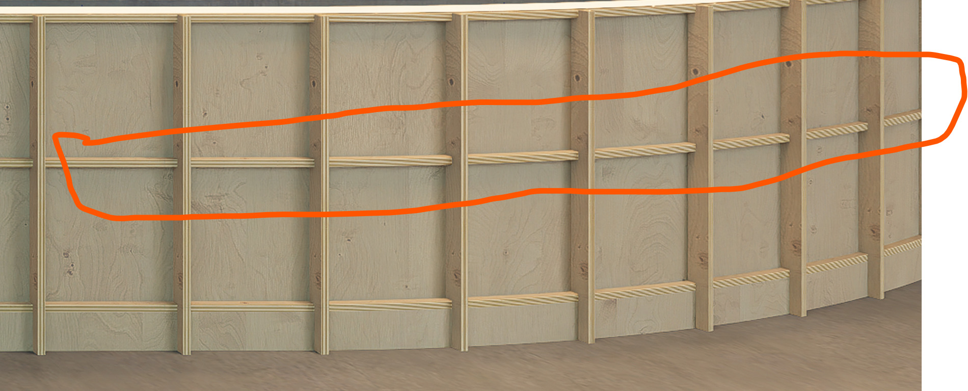

  1. Can you please clarify this for me:
    Is the team response message referring to what is showing up in the preview/working view, or what is actually rendered?
    Cause the moire effect is a visual distortion, but not an actual distortion. I do not have a problem with D5 showing it as a wavy pattern in the preview window; my main issue is with the output. On your side, did it happen on the rendered image too?
  2. And does the team suggest that if I change the whole pattern with a new one and replace it in the whole project, it might work? Let’s say some similar pattern, but as a new one?

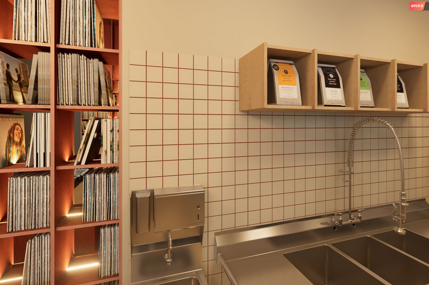

  3. I am still a bit worried about the other image I sent earlier with tile grouts showing wavy, which always happens when the SR is on, but in my case, it is always off. Sending the image again below

  1. The response is both for the preview and the final rendered image, since after rendering, zooming in/out would have a significant effect, such as the patterns showing normally when zoomed in.
  2. We tried changing the material from the online asset library > Wood Grain; since there were no prominent black line patterns, the issue was not evident. I think you can try to change the pattern, perhaps try to adjust the colour of the lines to something less dark or completely replace it with wood grain texture.
  3. As for the tile which appears distorted on your end, it is normal when we rendered it.
@Clov Thank you for the response.
I think there is a misunderstanding here.
My main issue is that the rendered image shows material like the miore effect “when zoomed in”. I mean, my final render is not accurate when zoomed in. Exactly the opposite of what you see on your side.
When I face this edge texture issue in my renders, and also considering the tiles’ grout showing wavy when I check the rendered image zoomed in, I feel like something is not functioning correctly on my side.
it is clearly different on my side.
How can we investigate this issue on my side?
