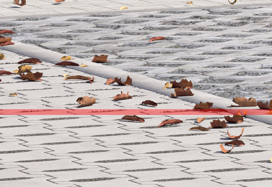

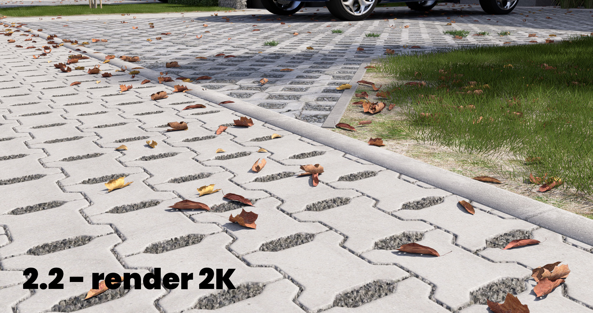

D5 2.2 losing displacement resolution in renders 8K+ and large scenes. At the beginning I have to tell that scene was prepared in 2.1 and everything was ok in previous version of D5.

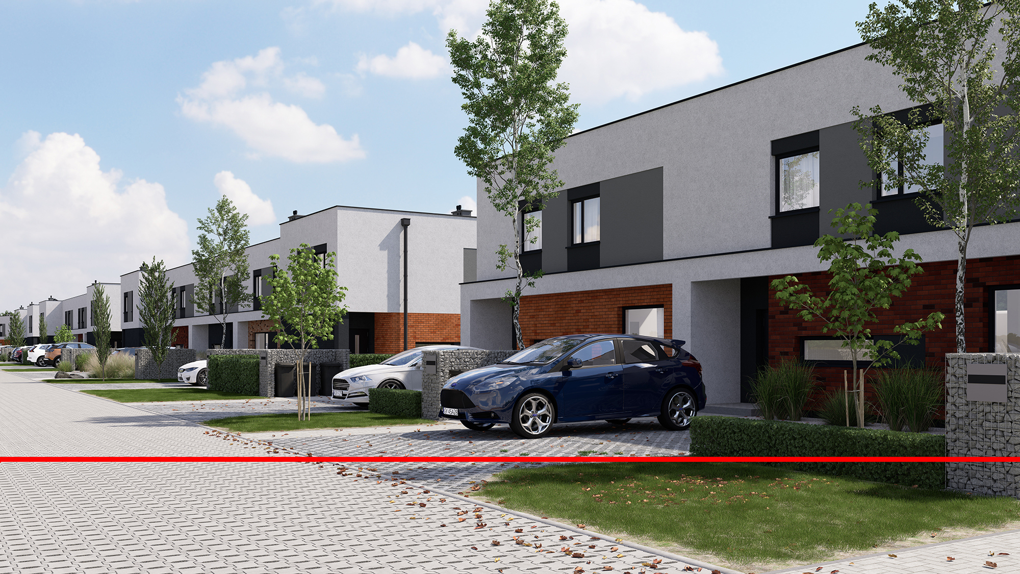

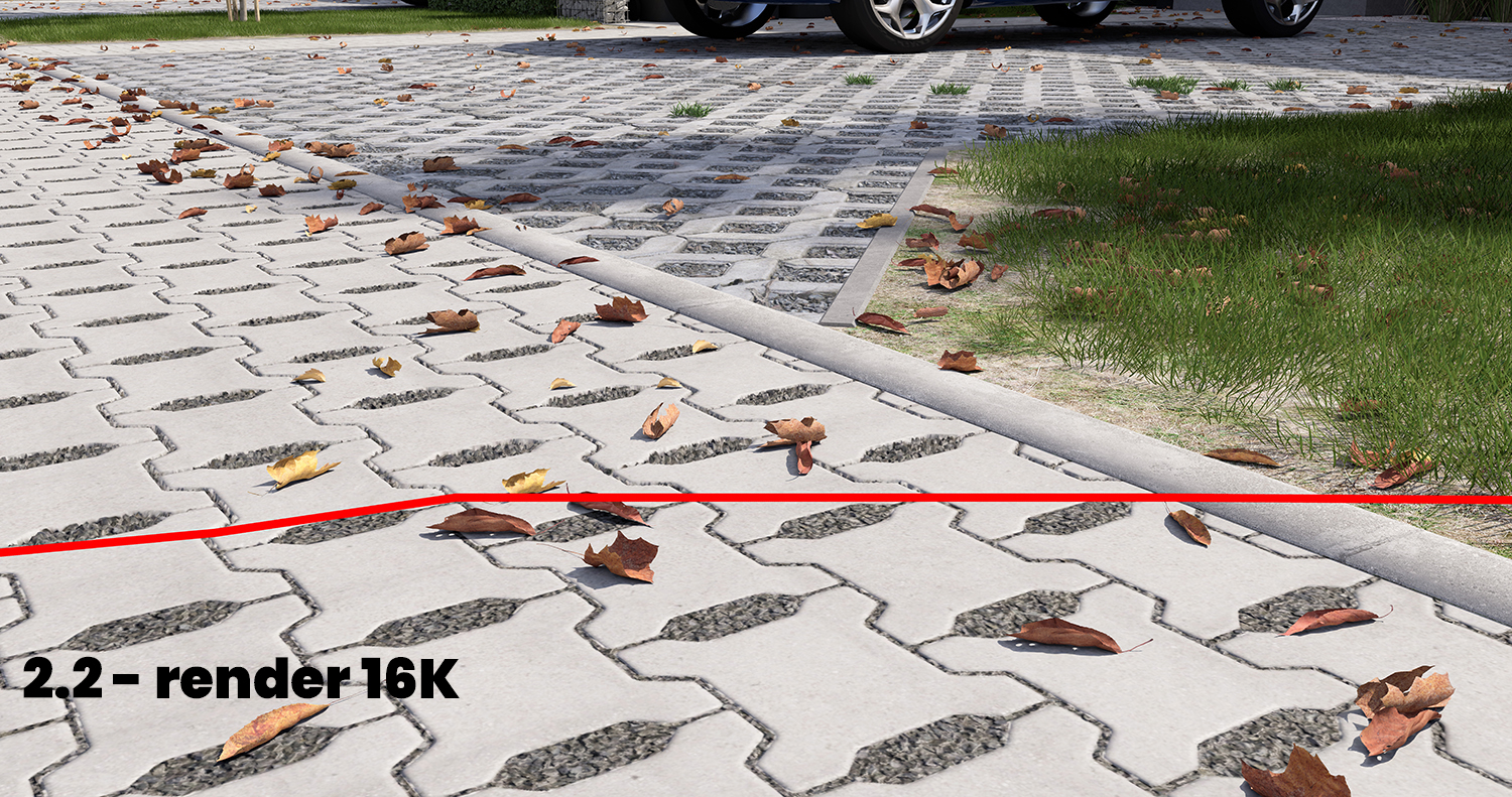

The problem appears in big scenes rendered in higher then 4K resolution. As You can see, displacement map is flat closer to camera. The area of real displacement starts after red line which as You can see is irregular. If camera is higher or shows more objects or larger area, displacement effect disappear for all displacement textures.
At start - after a scene is loaded - everything is ok in screen preview. The problem is visible on rendered images and sometimes in screen preview (but only after finishing high resolution rendering).
It looks like something with texture streaming is incorrect.
One more thing. In 2.2 displacement map behave different then in previous versions. In previous, increasing height value caused texture was “pushed” inside. Now is texture goes outside.

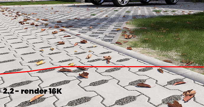

After many tests, updated graphic drivers and restarted scene from Sketchup directly to D5 the results are like below. Part of rendered image has correct displacement (above red line). Part of image closer to camera is flat.
Images up to 12K = displacement is ok. Above 12K - not. :frowning:
Hello, we have identified the issue related to Displacement materials in large scene files, and it will be fixed next month. If you want to join the beta testing and try it before public release, please check the private message I sent you.
