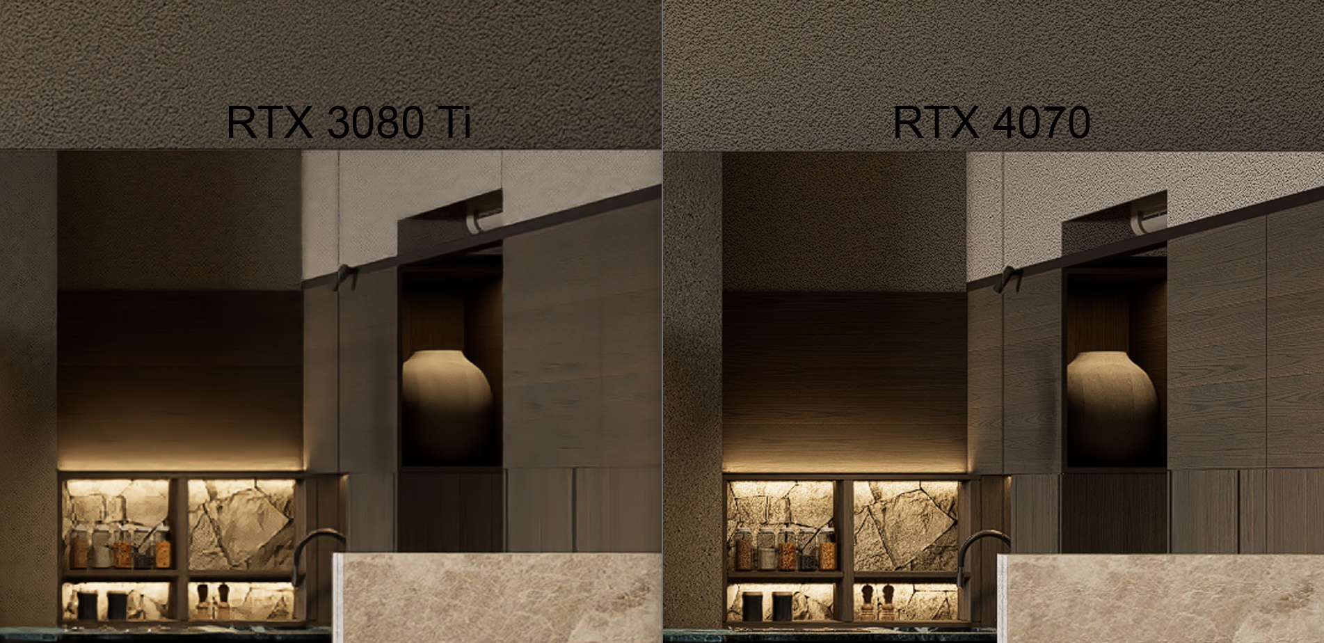

Different rendering quality in two difference PCs
Hi, i have an issue of different rendering qualities between two computers. As you can see from the comparison image that the result of RTX 4070 is sharper, higher quality texture, and better lighting quality.
Could you provide any insights into what might be causing this issue?

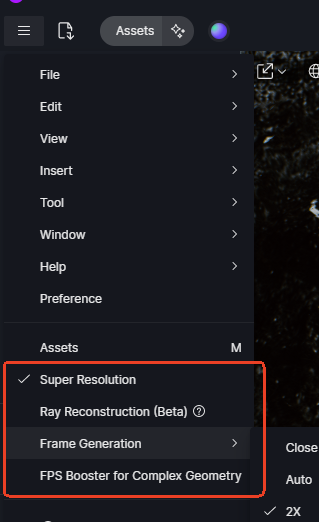

Hi @stanleygoenawan99 Some of the key differences between Rtx 30 series and Rtx 40 series in D5 is the support for DLSS Frame generation for improved render performance.

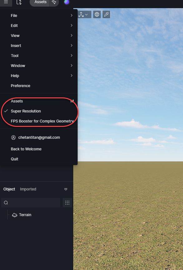

Can you tell me your D5 version and if the images were rendered with Super Resolution turned on? Additionally, the results would vary if different render settings, material and lighting settings were used. Thank you
hi, this is something new to see. i have used 3080ti but didn’t face such issue. 3080 ti render is blurred . all settings are same for both scenes? like dlss in file menu.
