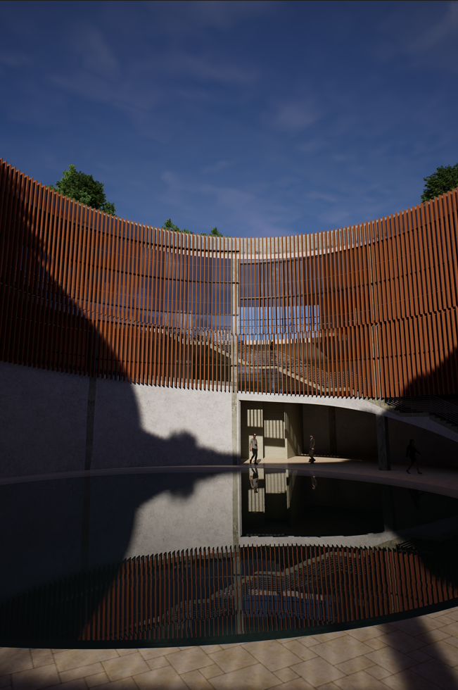

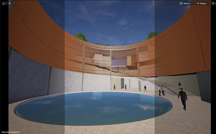

Hello, im currently dealing with this problem right now, the rendered image is so far from the preview image. I already restarted my pc but still… please help
Preview Image
Rendered Image
There are no shadows in your preview image. Make sure you have Realtime Quality set to Precise and/or press F4 before rendering to preview how a rendered image will look.
