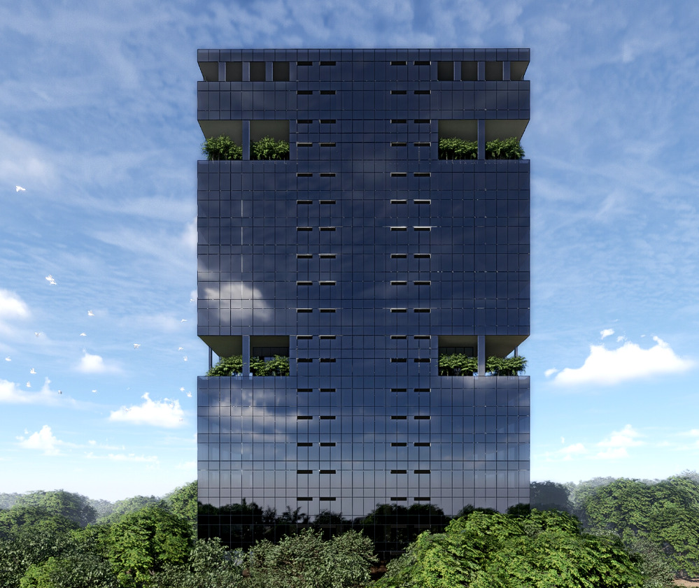

Hi Guys
ive rendered a video output in 2k and 30 fps but the results are strange
the viewport
and this is the screenshot from the video
there are some white artifacts on the glass, whats should i do to remove those?
Hi Guys
the viewport
hi, instead of rendering video output from d5 , do sequence render and make video on any video editor. i found quality degrade in video render. like shadow and reflections are not same as viewport. in sequence render quality is maintain as ur viewport.
Thankyou my friend ! ill give a try and return with the results
Hi! Sorry for this. Have your enabled SR or DLSS? Maybe turn them off and try to render again. If this issue persist, please send us your scene file. You can share a link here or send your file to our email. (support@d5techs.com, please describe the problem and attach the link of this post to your mail)
