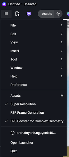

I saw on D5 Render, it have 2 kind of Super Resolution located in 2 different position

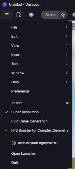

1: in the file tab

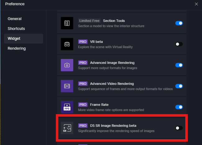

anh then other 1: in the Preferences > Widget > D5 SR Beta

So what the difference between them?

The Super Resolution option in the File menu is actually DLSS, and it affects animation/video rendering. It helps reduce video rendering time.
The D5 SR Beta in the Widget settings is for image rendering only. It speeds up still-image output but may cause a slight loss of detail since it uses D5’s own AI upscaling.
Hope this clears it up! Let me know if you need more help.
