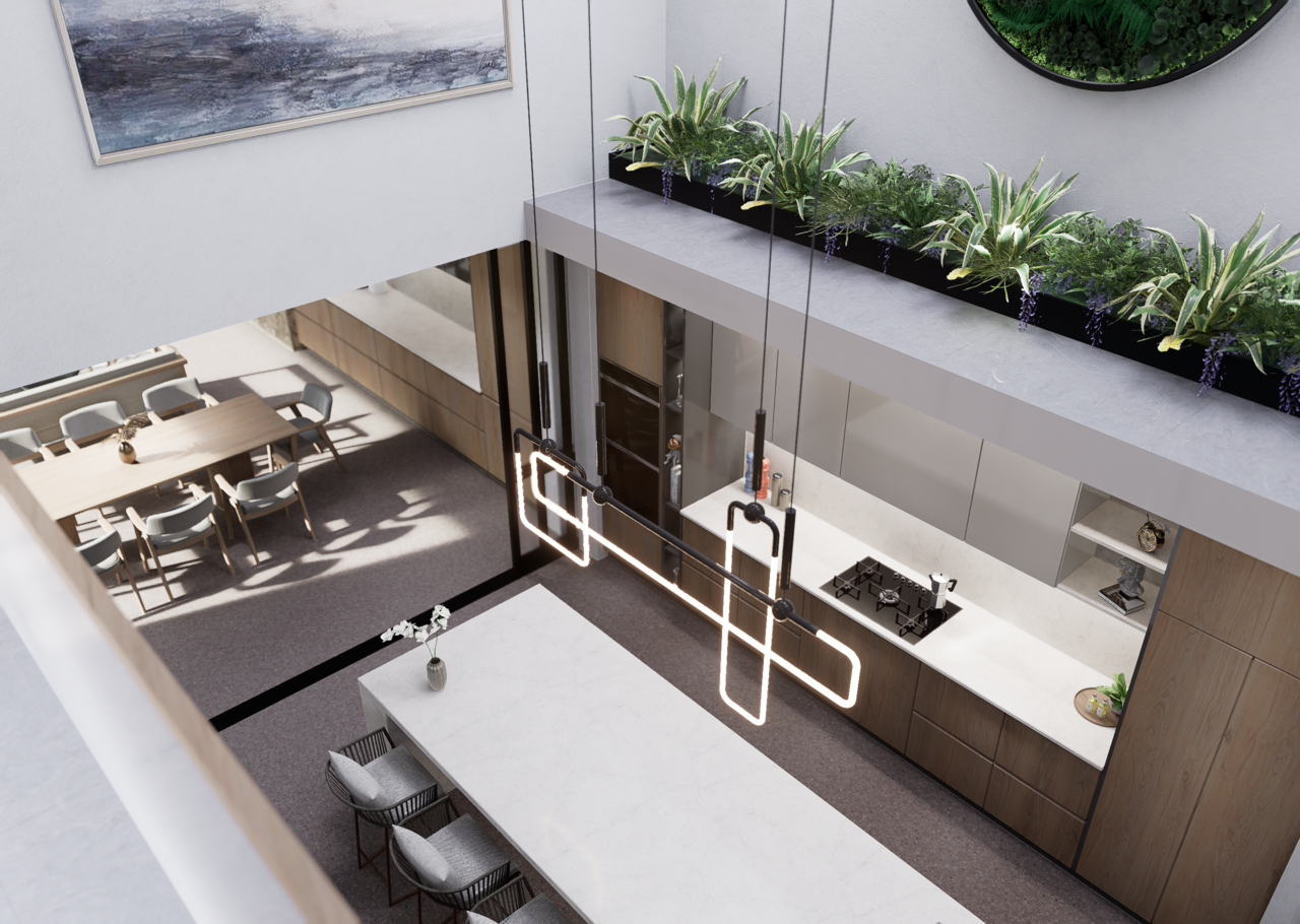

Depth of field. Blur = 5. Follow Focus on.
Depth of field. Blur = 10. Follow Focus on.
Have a look at the Pendant lights and kitchen counters - there is a noticeable graininess when the Depth of field blur setting is higher. However, reducing the blur, takes away from the nice foreground blur on the balustrade that is created with a high Blur of 10.

Yes, I suppose you could say that. I just feel that at a high render output, the blurriness of DOF should be “smooth” not grainy / pixelated. I suspect I am maybe doing something wrong (because I have seen beautiful renders produced with D5 without this problem). However I am not sure.
