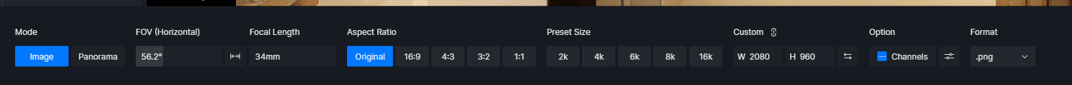

When you are navigating with the image setting on
you can setup screen resolution, FOV, format,… in the bar bellow
but this is useless because when you click to add a new scene it will ignore this setup and do wathever it is its default. Really unpractical.

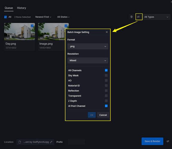

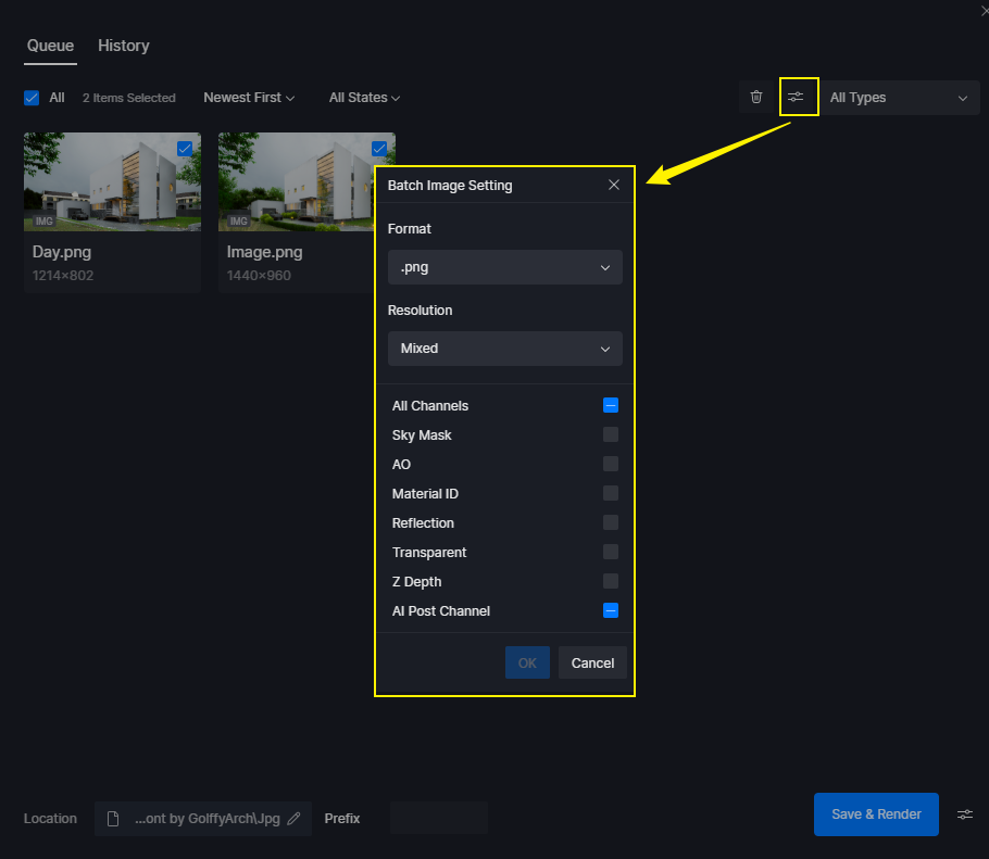

For now, there is no option to modify the default settings and creating a new scene will have you set these settings manually. But if you wish to speed up the process, you can use the Batch Image Setting option in Render Queue.
Note: FOV setting is unavailable on this portion, but FOV settings are retained in Scene Update.
