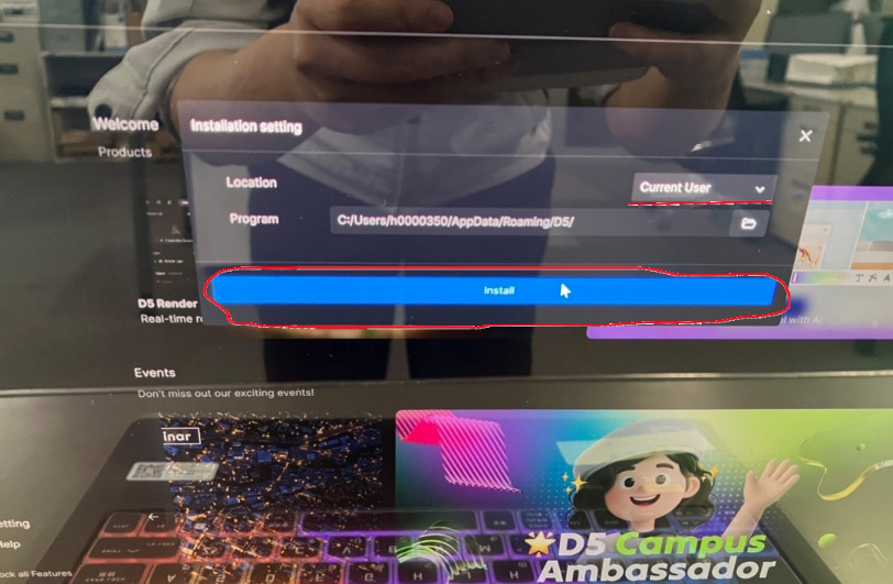

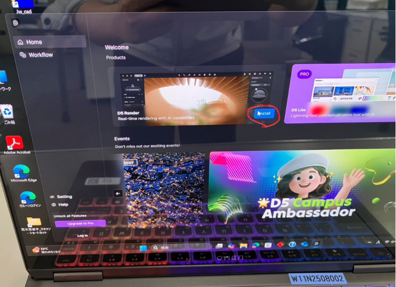

① Install D5 Launcher
② Log in to D5 Launcher
③ Install D5Render from “HOME”

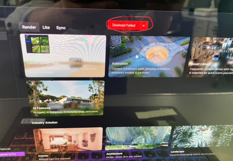

④ Download failed
As described above, the installation did not complete successfully, and I am having trouble.
Uninstalling and reinstalling the launcher did not resolve the issue.
I disconnected from the company network and tried using tethering, but the download still failed. Therefore, I don’t think it’s a network issue.
