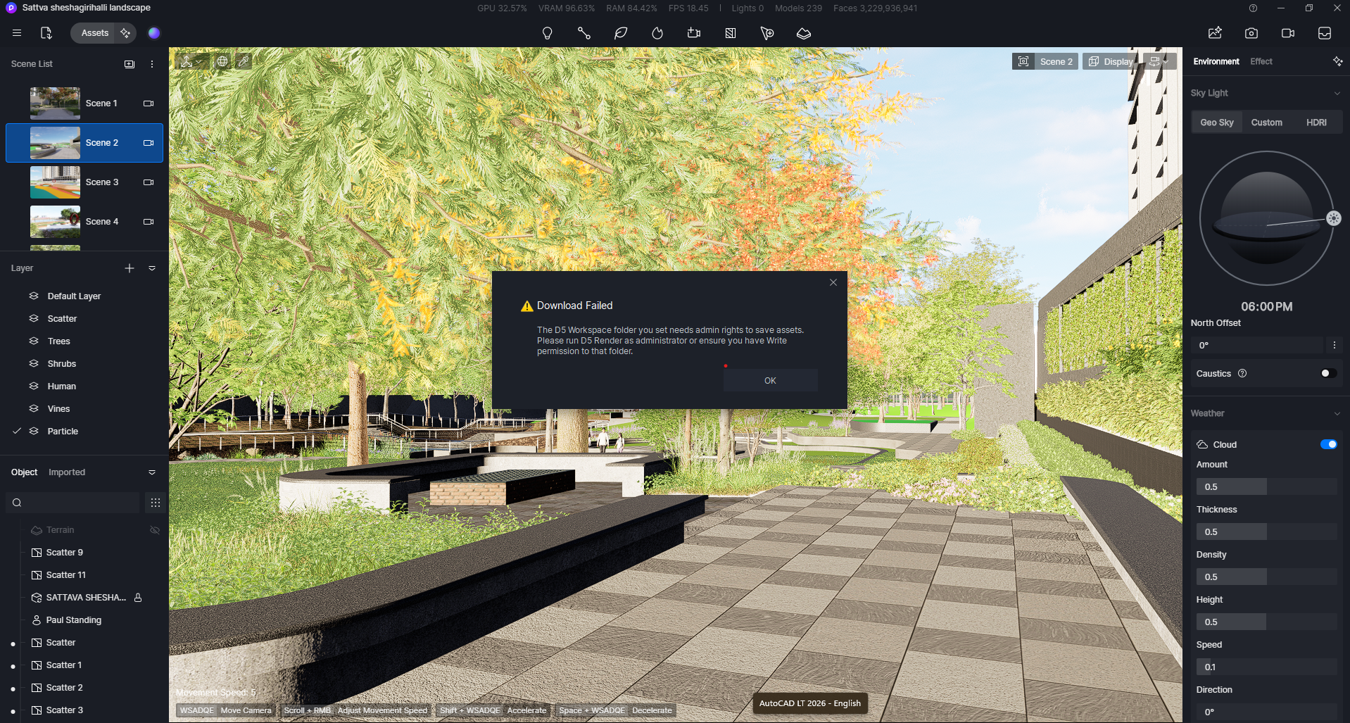

Until yesterday this issue was barely non existent but today for some reason all the models textures are gone and I am not able to download anything either. Whenever I do try to download, It gives me a prompt ( attaching a screen shot).
Just restarted my machine and its fixed.
Although it was fixed after the restart, can you check if you have “Full Control” to the location of your D5 Workspace folder?

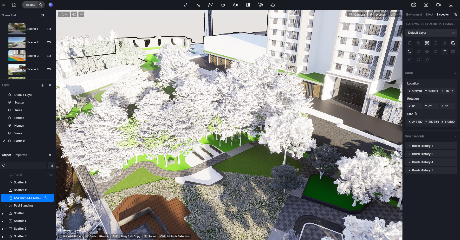

- Additionally, I noticed some white models. Was this file stored in a cloud storage?
I save the files directly in onedrive as it is convenient. But I will try to save it to local drive.
