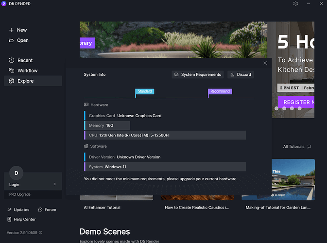

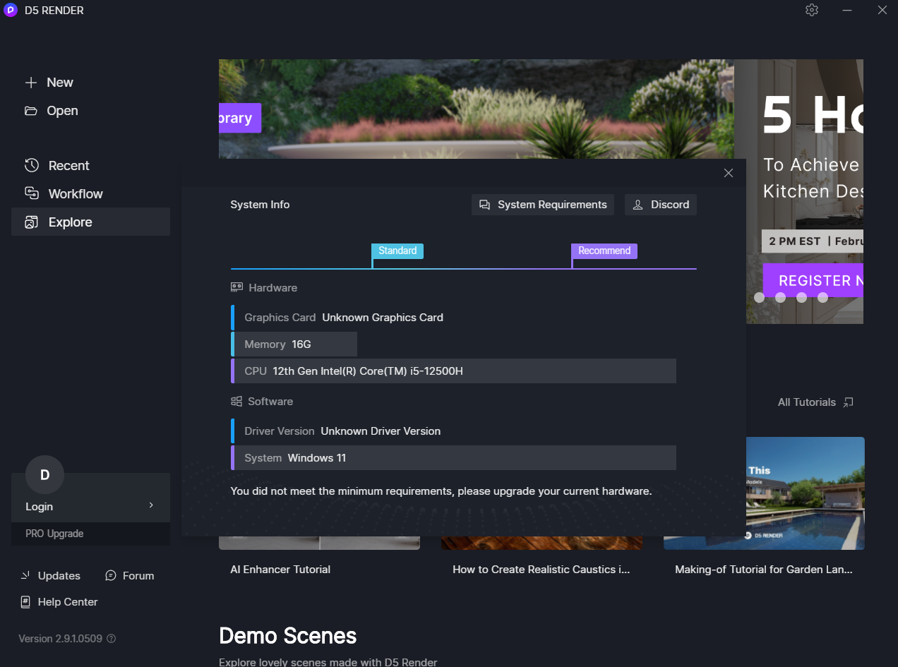

First, it won’t let me past this screen
I’m not sure why it would appear as Unknown

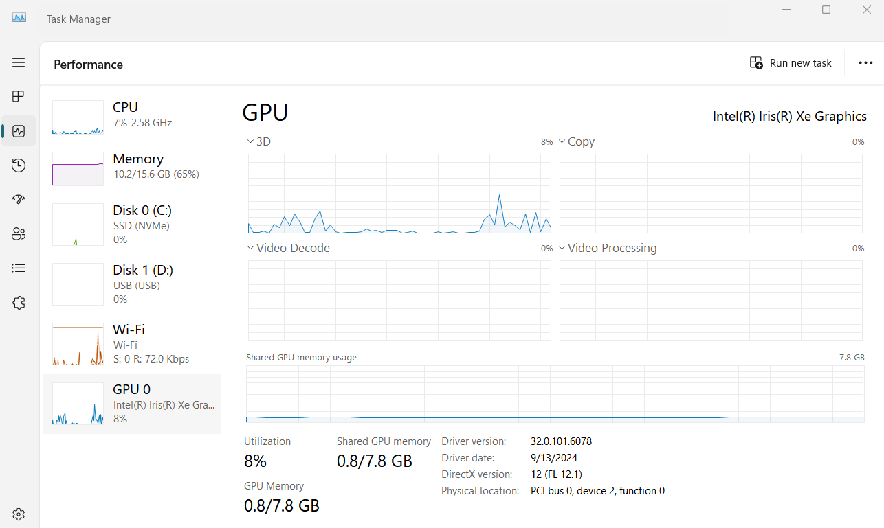

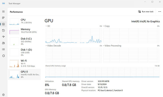

Hi @a00836385, Thank you for sending the screenshot. Your GPU is not supported. Could you please send a screenshot of your Task Manager so we can confirm the available GPU?
Why prompt ‘The program cannot be launched because of DLL errors…’ or ‘Program Startup Failed’? | User Manual
Hi @a00836385,
Have you been using D5 on this computer with Intel® Iris® Xe Graphics? Unfortunately, your current GPU is not supported and will not be able to run D5 Render. What is your computer model? We are aware of some cases where the integrated GPU is rather being utilised instead of the dedicated GPU in certain laptop models.
