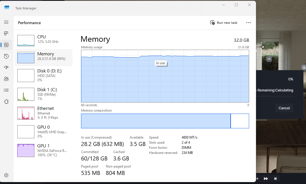

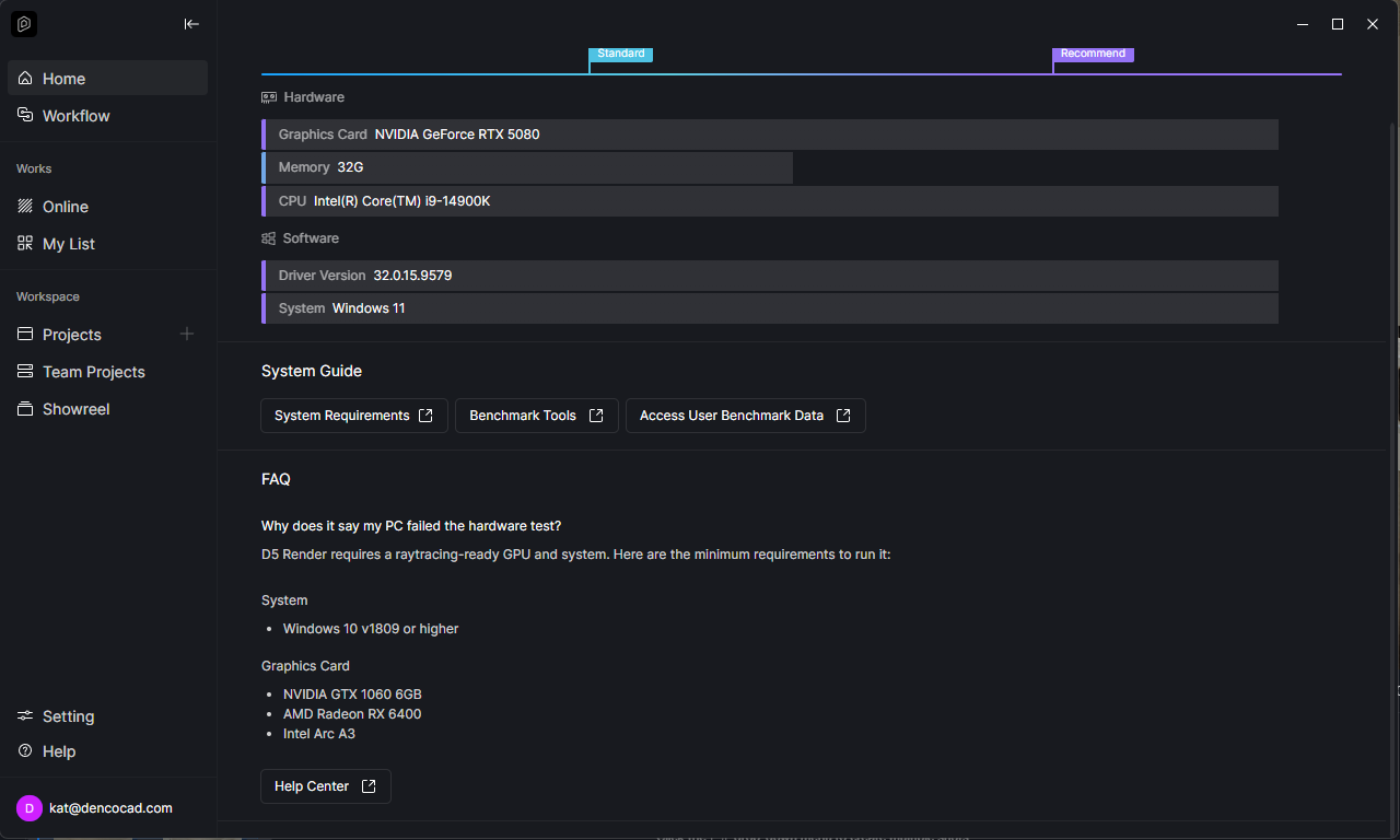

Hi me and my team also done this with my pc but the rendering still takes longer than usual with my one clip video it takes 10 to 30 minutes to rende and calculate.
Hi @kat
Can you give us full context on the issue?
Hi @kat

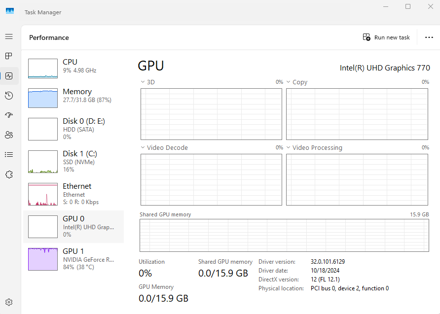

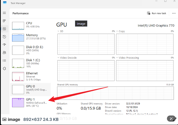

  • Please send us the GPU 1 screenshot showing your dedicated gpu not your integrated gpu

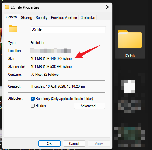

  • The .drs file is not the whole d5 file; you should check the file folder’s properties to see the file size.
  • Please also include the render time that shows after you have finished rendering the image.
