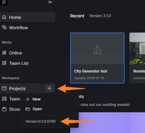

Hi @tochipheng
Just to confirm, may I know which specific 3.1 build/version you’re currently running?
  • We received similar reports a few days ago, and we were able to fix it in our most recent build, specifically 3.1.0.0746
    3.1.0.0746
If the issue persists, can you please confirm whether it is evident across all of your files, even with an empty D5 scene file?
