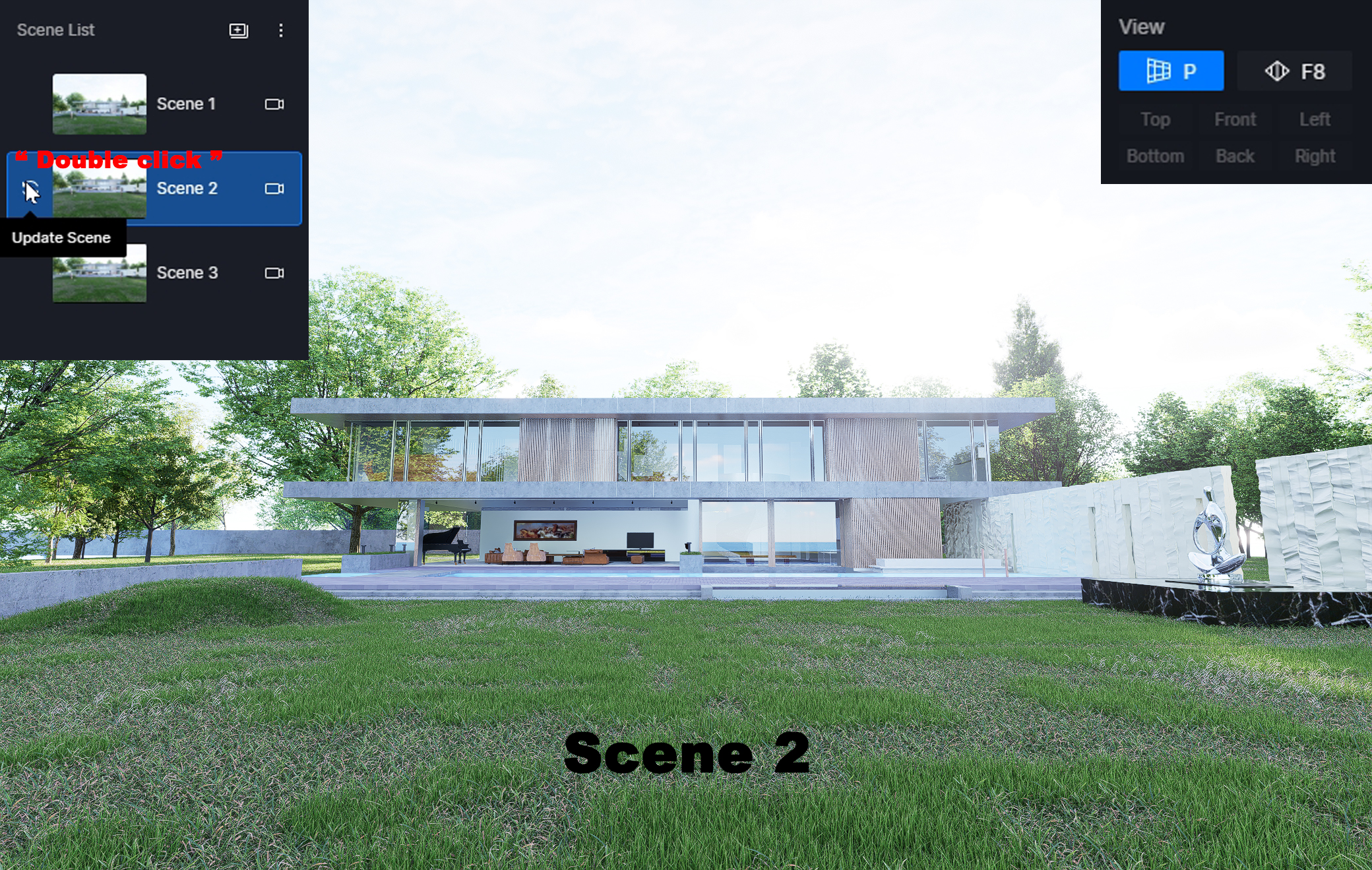

We know that when the Scene in the Scene List is Two-Point Perspective (Scene 1), the following error occurs
ERROR_1: Scene 2
Two clicks on “Update Scene” will remove the Two-Point Perspective and put the scene in Perspective.

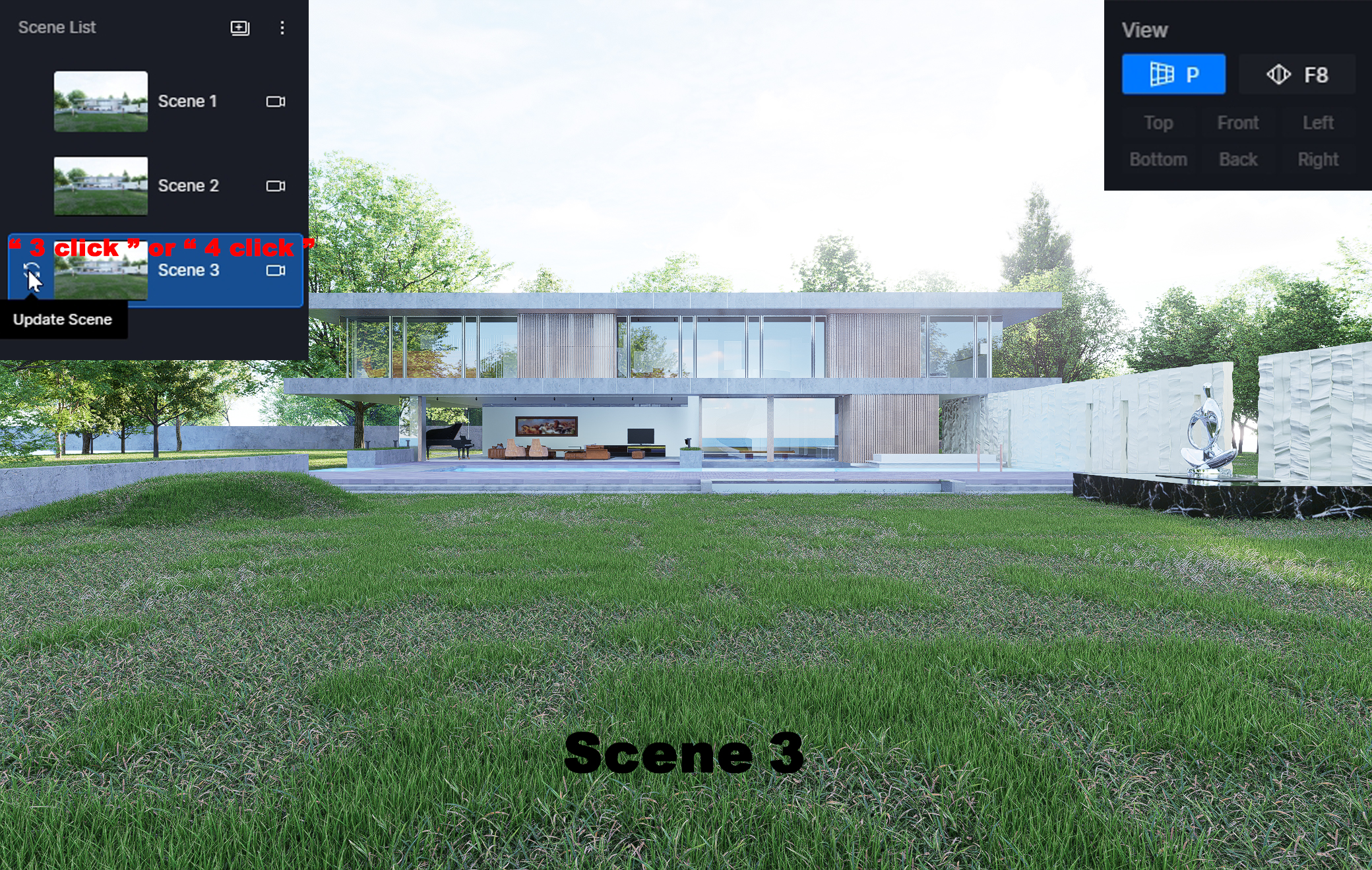

ERROR_2: Scene 3:.
When 3 or 4 clicks are made on Update Scene, there are sometimes cases where film offset occurs in the vertical axis (Z-axis) direction.
The above ERROR occurs in both COMMUNITY and PRO versions. It did not occur with D5RENDER 2.8 on another PC.

Hi there; I apologize for the inconvenience this issue has caused. I have tried to recreate these issues on my and and I can confirm that the “Double Clicking the update scene will change the two-point view to perspective only” while I cannot seem to observe the slight change of Position when I triple click or quadruple click the update scene. Nevertheless, I have reported this issue to my team and will give you updates. Thank you so much.
I recorded the screen while operating D5RENDER2.9.
I added Scene 1 and clicked Update Scene three times.
Film shift cannot be seen in Scene 2 and Scene 3,
but in Scene 4 you can see that film shift has occurred on the vertical axis.
