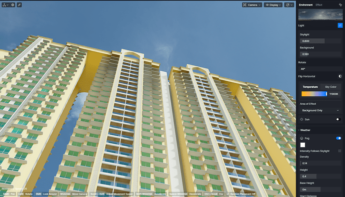

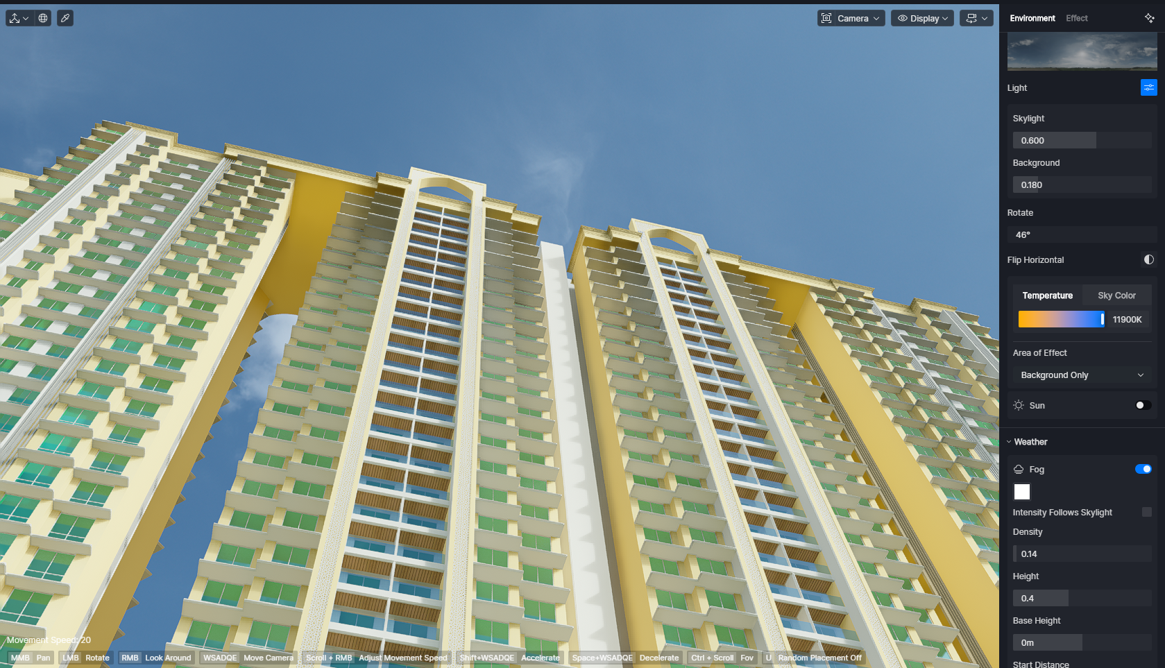

Hi team,
As suggested, I’ve emailed the D5 scene via WeTransfer (using the given title). I’ve also attached 3 renders of the same scene with identical lighting.
Issue (repeatable):
Across multiple projects, the underside of the chajja (overhang/soffit) looks too dark in wide/long shots, but when I move the camera close to the building it becomes bright again—even with Auto Exposure OFF.
Steps to reproduce (in the file I sent):
  1. Open the scene and render a long shot → soffit underside is very dark.
  2. Move the camera closer and render again → soffit underside becomes much brighter.
  3. Auto Exposure is OFF in both tests.
  • Is this a known camera-distance issue (AO/SSGI/tone mapping) in 2.11?
  • Any recommended settings to keep soffit brightness consistent between wide and close shots without adding fill lights?
  • If there’s a patch or a specific combo (GI/AO/Environment), I’m happy to test and report back.
    Please note that this problem was there in earlier version also.
    Thanks for looking into this!

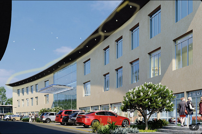

HDRI
Close up
Wide
Hi team,
Thanks for the suggestions. I also tried changing the material (making the soffit brighter and adding a small emissive). It lifts the dark area, but it is not practical for production:
  • Many areas need lifting and they do not share the same material.
  • Brightness still changes with camera distance (it gets brighter when I move closer), even with Auto Exposure OFF.
  • For aerial/long shots, I would have to change materials again, which breaks a consistent workflow.
Because of this, I believe the issue is more likely a GI/SSAO/shadow behavior tied to camera distance, not a material setup problem. My scene and test renders were shared via WeTransfer—please feel free to test on your side.
About the images you shared:
The examples are okay, though the overall rendering is not great. In your renders too, the underside area looks too dark—that is exactly what I am reporting. Also, your close-up shots are of the middle building. If you move the camera close to the front two buildings, you will notice the underside becomes brighter with your own settings. This matches the camera-distance issue I am seeing.
Why this may be missed by others:
On this forum, many posts are small buildings/bungalows with close-up views. Those projects do not need very wide-angle shots, so this problem might not show up and fewer people notice it.
Request:
  • Could you confirm if this is a known issue/bug in D5 Render 2.11?
  • If yes, please share a ticket/reference ID and next steps.
  • If not, could you provide a settings-based workaround (GI, AO, Environment/Skylight, tone mapping) that keeps soffit brightness consistent between wide and close shots without emissive or extra fill lights?
I am happy to test any proposed settings or a test build and report back. Thank you for looking into this.

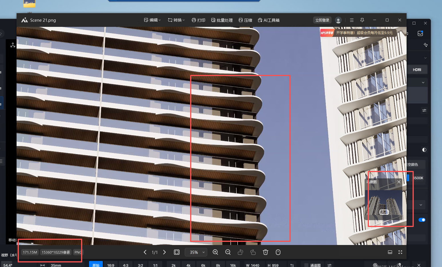

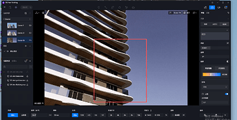

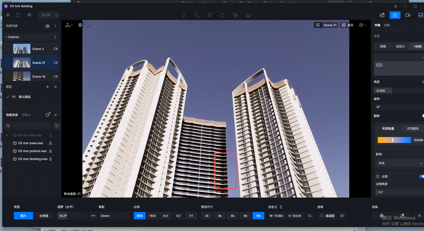

Unresolved GI Color Gradient Issue Under Chajja in D5 Render 3.0 (Critical for High-Rise Projects)
We are raising this issue again after upgrading to D5 Render 3.0, because it still persists and has not been addressed, despite being a major professional workflow problem for large residential and high-rise projects.
Issue Description
When rendering buildings with chajjas / slabs / horizontal projections, we observe a noticeable and unnatural GI-driven color gradient:
  • The chajja surface near the camera appears correctly lit and matches the intended material color.
  • As the same chajja surface moves higher or farther from the camera, it gradually becomes darker, creating a visible gradient.
  • This is not a texture issue, not UV-related, and not material roughness.
  • The effect becomes very prominent in animation, where this unwanted shading shift is clearly visible and looks incorrect.
This behavior is especially problematic in:
  • High-rise residential towers
  • Large housing complexes
  • Repetitive architectural elements (balconies, slabs, chajjas)
In real-world construction, these elements do not visually darken based purely on height or camera distance. What we are seeing looks like GI color bleeding / energy falloff behaving incorrectly across large vertical extents.
Why This Is a Serious Professional Issue
  • In close-up views, materials look correct.
  • In full building or elevation views, the same material appears inconsistent.
  • In fly-through or vertical pan animations, the gradient shift is distracting and unrealistic.
  • This forces artists to either:
    • Over see color correction in post, or
    • Artificially tweak materials per level (which breaks physically based workflows)
Neither is acceptable for professional architectural visualization.
What This Is Likely Related To
Based on testing, this seems related to:
  • GI bounce accumulation or decay over vertical distance
  • Screen-space or camera-dependent GI behavior
  • Lack of control over GI uniformity on large planar architectural elements
What We Need as a Solution
At least one of the following would help significantly:
  1. A GI uniformity or stabilization control for large architectural surfaces
  2. An option to reduce or clamp GI color variation across long vertical spans
  3. A way to decouple GI intensity from camera distance for static architecture
  4. Improved handling of repetitive slab/chajja geometry in large buildings
Attached Evidence
We are attaching screenshots from D5 Render 3.0 clearly showing:
  • Correct color near camera
  • Progressive darkening of the same chajja at higher levels
  • Visible gradient artifacts that become obvious in animation
This issue existed before and still exists after the 3.0 upgrade. For anyone doing professional high-rise or residential work, this is not a minor visual quirk — it directly affects output quality and client deliverables.
We strongly request the D5 team to acknowledge this as a GI system limitation and consider it for correction or user-level control in upcoming updates.
