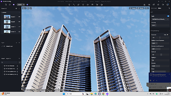

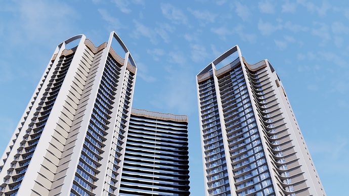

As suggested, I’ve emailed the D5 scene via WeTransfer (using the given title). I’ve also attached 3 renders of the same scene with identical lighting.

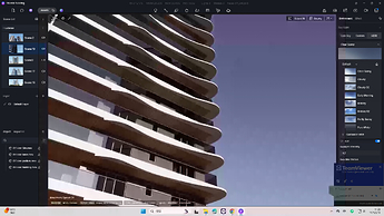

Issue (repeatable):
Across multiple projects, the underside of the chajja (overhang/soffit) looks too dark in wide/long shots, but when I move the camera close to the building it becomes bright again—even with Auto Exposure OFF.
Steps to reproduce (in the file I sent):
Open the scene and render a long shot → soffit underside is very dark.
Move the camera closer and render again → soffit underside becomes much brighter.
Auto Exposure is OFF in both tests.
Is this a known camera-distance issue (AO/SSGI/tone mapping) in 2.11?
Any recommended settings to keep soffit brightness consistent between wide and close shots without adding fill lights?

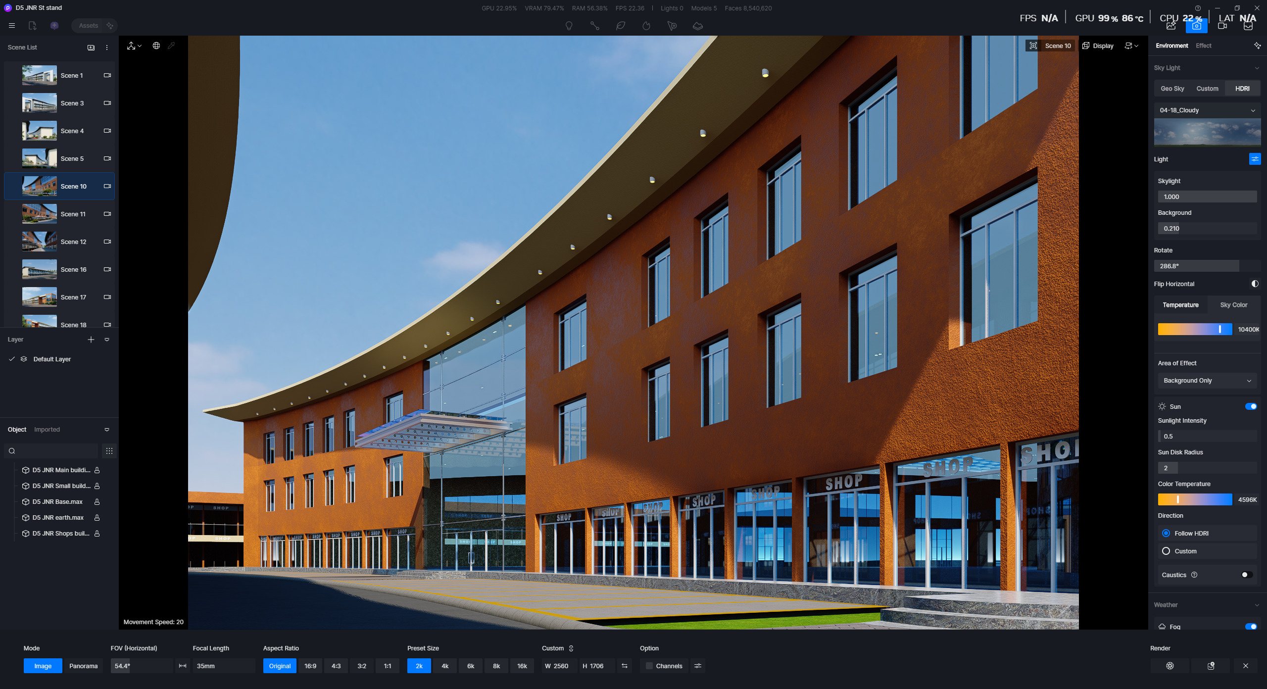

Can you also share the file where this image is from? The one you have sent seems to have these dark overhang because of environmental light positioning and the lack of lighting assets. While the first image you have shared seems to be more unnatural.
The images I shared are all from the same file. The first two images are close-up shots of the same angle and lighting as the long shots. I’ve noticed that the underside of the chajja (overhang/soffit) appears too dark in the wide/long shots, but becomes brighter when the camera is closer to the building, even with Auto Exposure turned off. This can be verified in the same file. All images shared recently are from the same project, although the thread initially included three different projects.
My Apologies, I wasn’t able to link the image that I was talking about. Anyway, the other file also displayed similarly but acquiring this file may also help us in determining the issue. Thank you.
I have sent you the requested file. Please note that this project differs from those with long shots of high-residential towers. This project primarily uses close-up shots. When using long shots, the underside appears dark; it brightens when closer. this is the core problem. This is the final version of the file; I’ve adjusted the material settings to improve brightness, unlike the earlier version in your screenshot. Please do the needful.

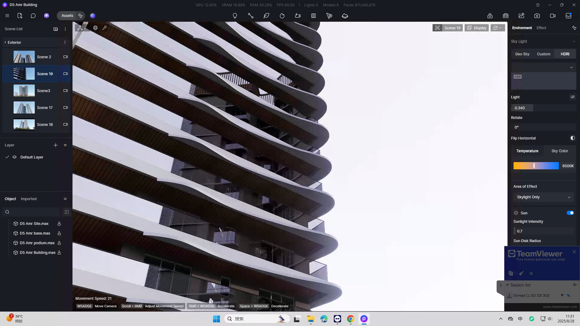

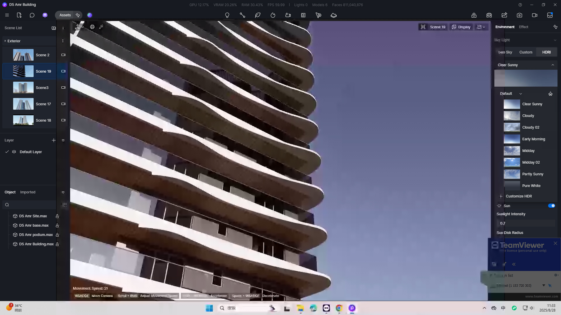

Alright, I just tested both of your files. So basically, this file that you have recently sent does not have any major issues regarding the surface darkening compared to the residential tower file?
Could you please clarify what changes you made to resolve the dark soffit issue in the first file? Because, based on the first image you sent, the soffit material still appears dark. It would be helpful if you could try applying those same changes to that file (High Residential Towers) as well.
As for the high residential tower file, both wide and close-up shots yield the same results; these surfaces are relatively darker. I tried changing the Sky Lights from Geo & Sky to HDRI, and it’s better.
I think you can activate this specific material’s emissivity, just to make it appear brighter
Or simply use a bright HDRI
Both suggestions can be done at the same time if changing to HDRI is still not what you expect these surfaces to look like.

After our team did some tests, this is currently underexpectation.
The preview resolution is very low, and when viewed from a distance, many details get blurred out—leaving you with just a dark, indistinct blob. But if you take this wide-angle lens, upscale it to 16K, and zoom in, you’ll see that, surprisingly, it’s actually quite detailed.
As for the file that you mentioned at first. It looks like his material settings aren’t quite right—for example, adding a bit of highlight and reflection to the wall, and then lowering the roughness of the eaves material while introducing just a touch of reflection could help bring it to life.

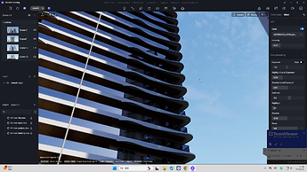

Attached Evidence
We are attaching screenshots from D5 Render 3.0 clearly showing:
Correct color near camera
Progressive darkening of the same chajja at higher levels
Visible gradient artifacts that become obvious in animation
This issue existed before and still exists after the 3.0 upgrade. For anyone doing professional high-rise or residential work, this is not a minor visual quirk — it directly affects output quality and client deliverables.
