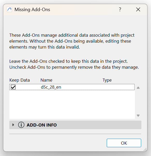

It’s installed on my D drive, same as archicad and the rest of the D5 software. I just repaired archicad and attempted to install livesync before launching archicad as I saw somewhere people had issues installing after launching. I get this pop up when opening any file
I both downloaded it through the site and through the launcher, neither have worked. I have restarted both archicad and my computer - trying all combination of uninstall/restart/install/open that I can.
Update: repairing archicad back to 28, then installing 28.3, then installing livesync without opening Archicad, then opening archicad and ticking D5 in the addon manager, and letting it reload finally worked.
