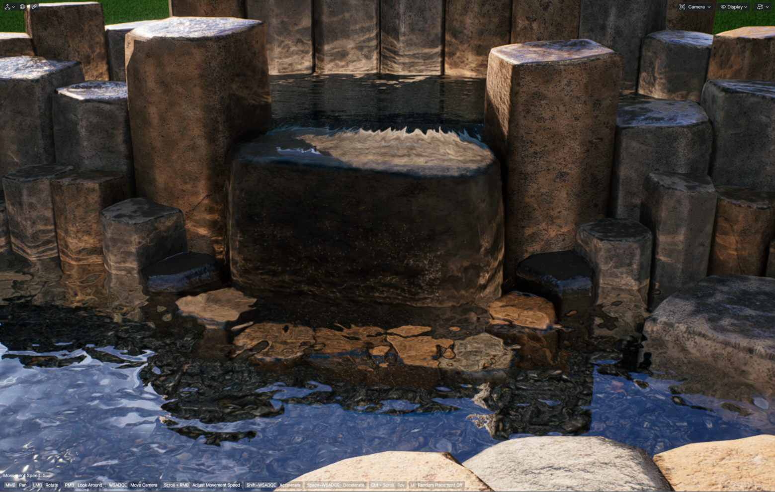

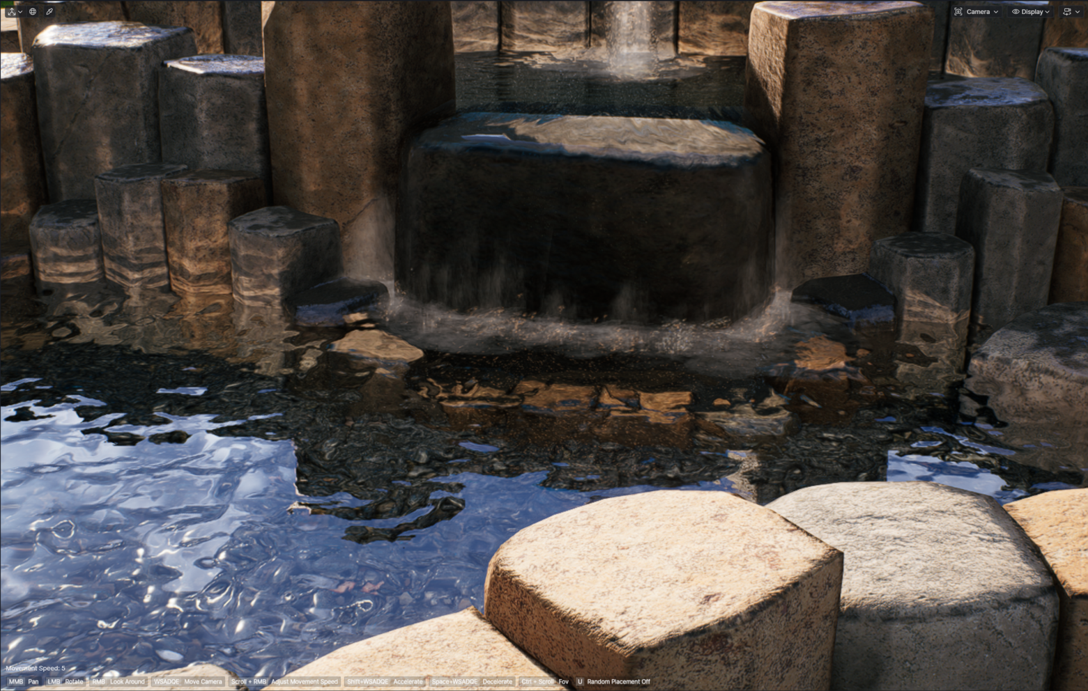

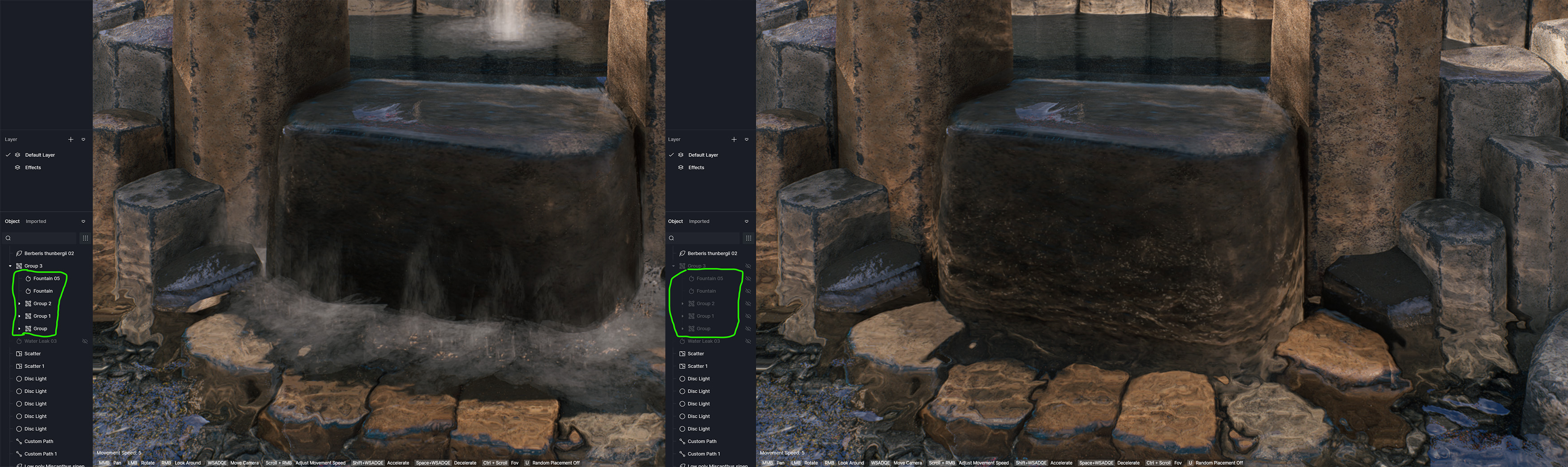

I’m working on a water feature and I’m having trouble when adding particles from the asset library.
The particles seems to be casting shadows and blocking the caustics coming up from the water.
Is there away to stop the particles from casting shadows or affecting caustics?
I’m using D5pro version 3.0.1
Thanks in advance for any help.
Particles hidden
Particles shown

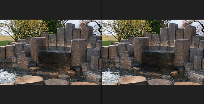

I just tested your file:
  • The left image has no particles, and the right image has particles enabled.
  • I’m using D5 Render 3.0.1.0683 with the latest NVIDIA Drivers, and with Path Tracing enabled.
We seem to have differentiating results, most especially when the particle is enabled.

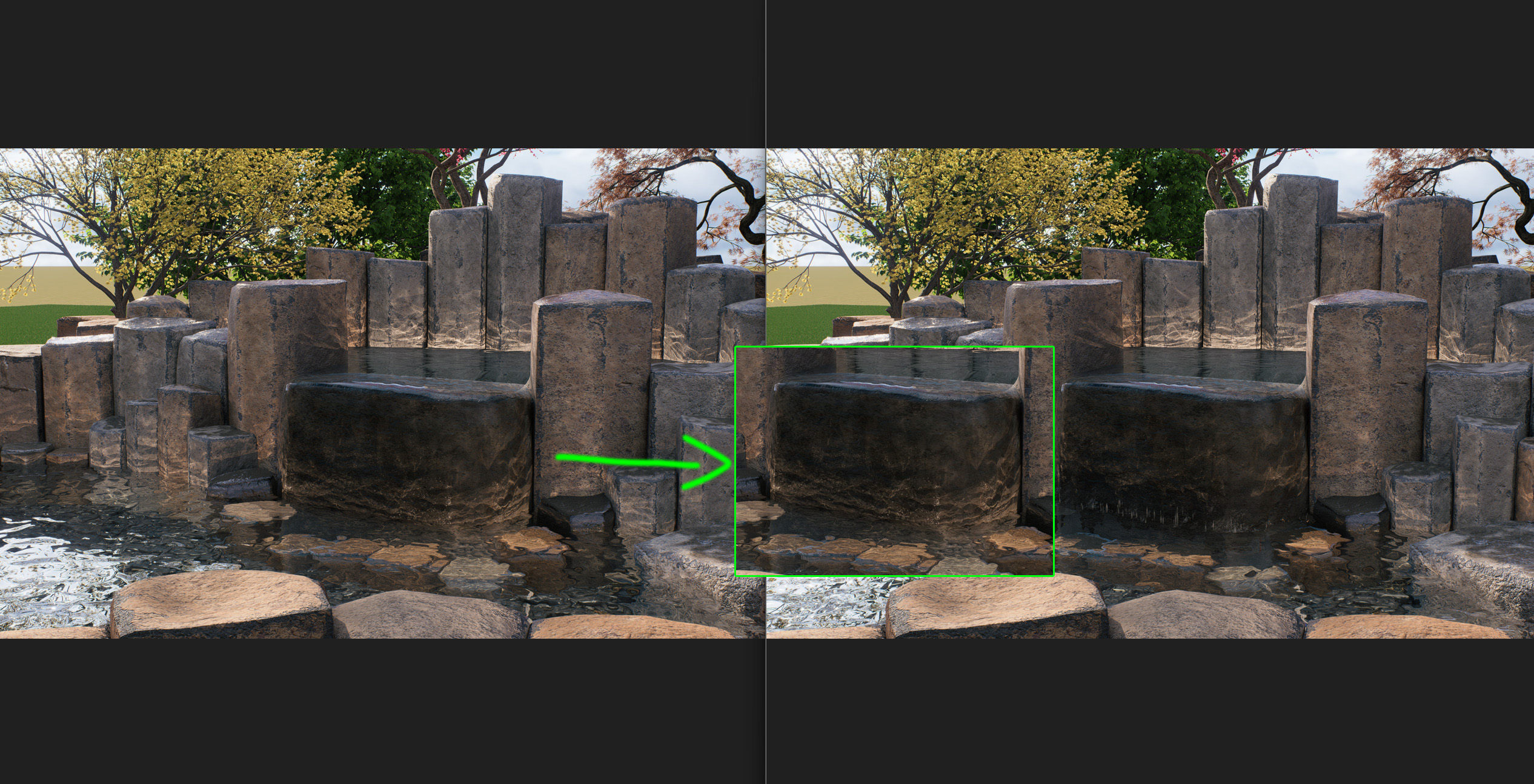

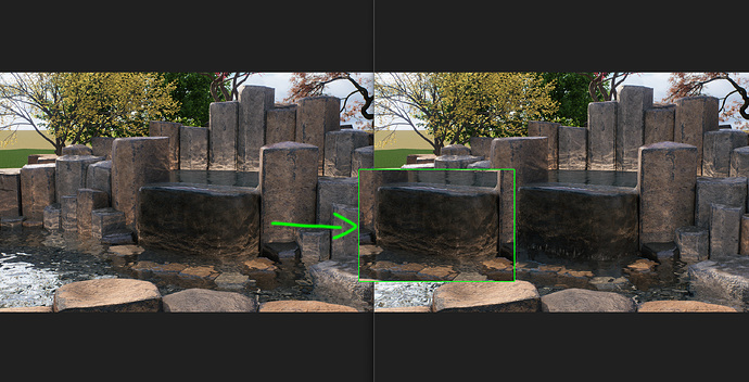

Hi @Clov I’ll have to try reinstalling my drivers but the issue is present in your screenshot.
I copied part of the no particles render and moved it over to the particles enabled render and you can see the difference.
Also the difference is more noticeable with all of the particles enabled.

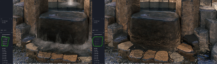

I’ve uploaded some screen recording after reinstalling my drivers that better illustrate the issue.
Particles Off
Particles On
