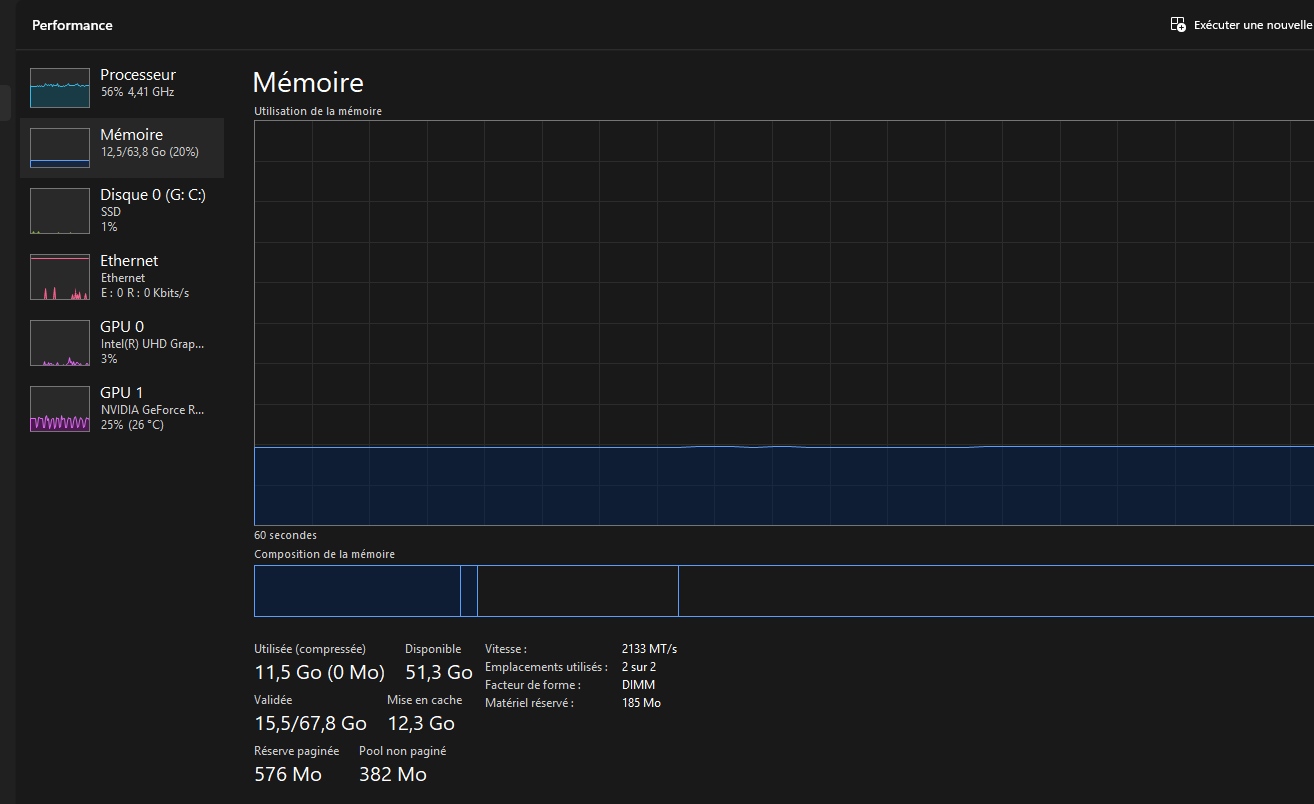

I hid the two big scatters, deleted the brush records and my vram remains 98 percent full.
Hi there,
Thank you for sending these images. Were they opened simultaneously with your current D5 Project File? I recommend opening them concurrently to observe real-time statistics. Additionally, try hiding all elements first, then unhide them in the specific scenes where they are needed. It might be helpful to group elements according to the scenes they belong to.
Have you tried deleting the pak files to see if this alleviates the issue you’re experiencing? Please let me know if this helps.
