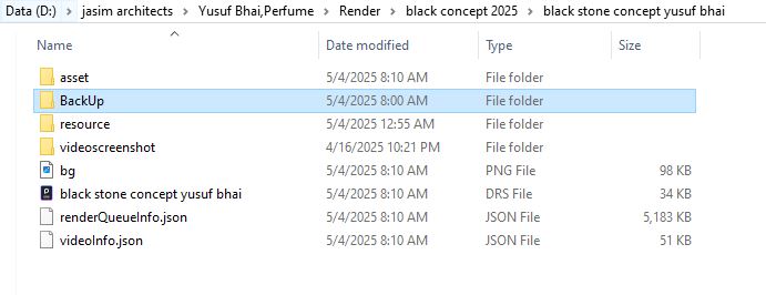

my d5 file keeps crashing while opening. it doesnt even hit 20% and just crashes. not notifications or anything.
all the related file are in the same file. even tried renaming the backup files to open. even those dont open.

Hi @jasimcm96 I apologize for the inconvenience. Are you able to open other project files without any issues?
I recommend deleting some of the downloaded assets saved in your βf2β folder. The βf2β folder contains cache files downloaded from the online library to your local device, but please note that you will need to re-download these assets after deletion.
Please locate and delete the βf2β folder from your workspace directory. This should help you regain access to your file.
yes , im able to open other files without an issue. should i still delete them?
hey anthony,
it worked .thanks alot.
