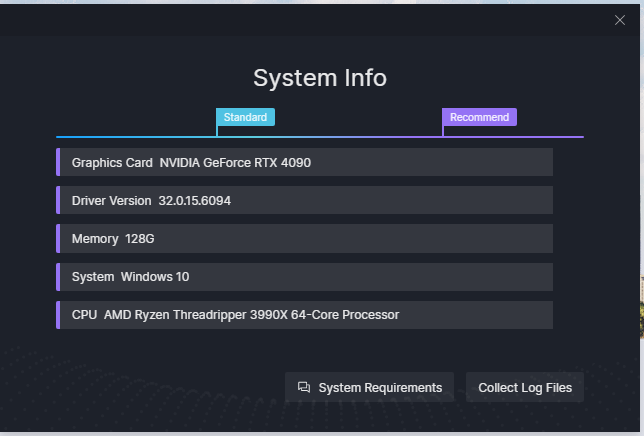

Hi thank you for the response, i feel like these are a bit too generic solution. i did reduce our model assets in the project file but the vram usage are stil above 90% at all time.
In term of pc, i think we have a monster already.
may i know what else could i do to optimise the project file?
could this all be due to hardware issue that caausing to crash?
