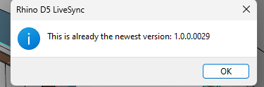

I still need to confirm the plugin version that you are using. Is it LiveSync or Sync plugin? The latest version of D5 LiveSync for Rhino is Ver.1.0.0.0029 released last month, and you can download it here:
Workflow | D5 LiveSync for Rhino | User Manual (d5render.com)
You can check the version within Rhino:
Then I will confirm with the team with more details of version compatibility and get back to you. Thank you.
Hi @Leah_Li
No problem! I am really happy for all the new features and how good the software is compared to other renderengines, so i am happy to help :slight_smile:
Here is a screenshot of the d5 livesync i am using:
Screenshot 2024-08-08 122336
