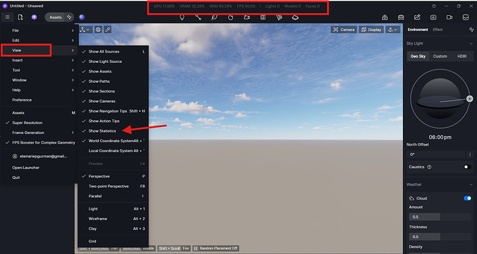

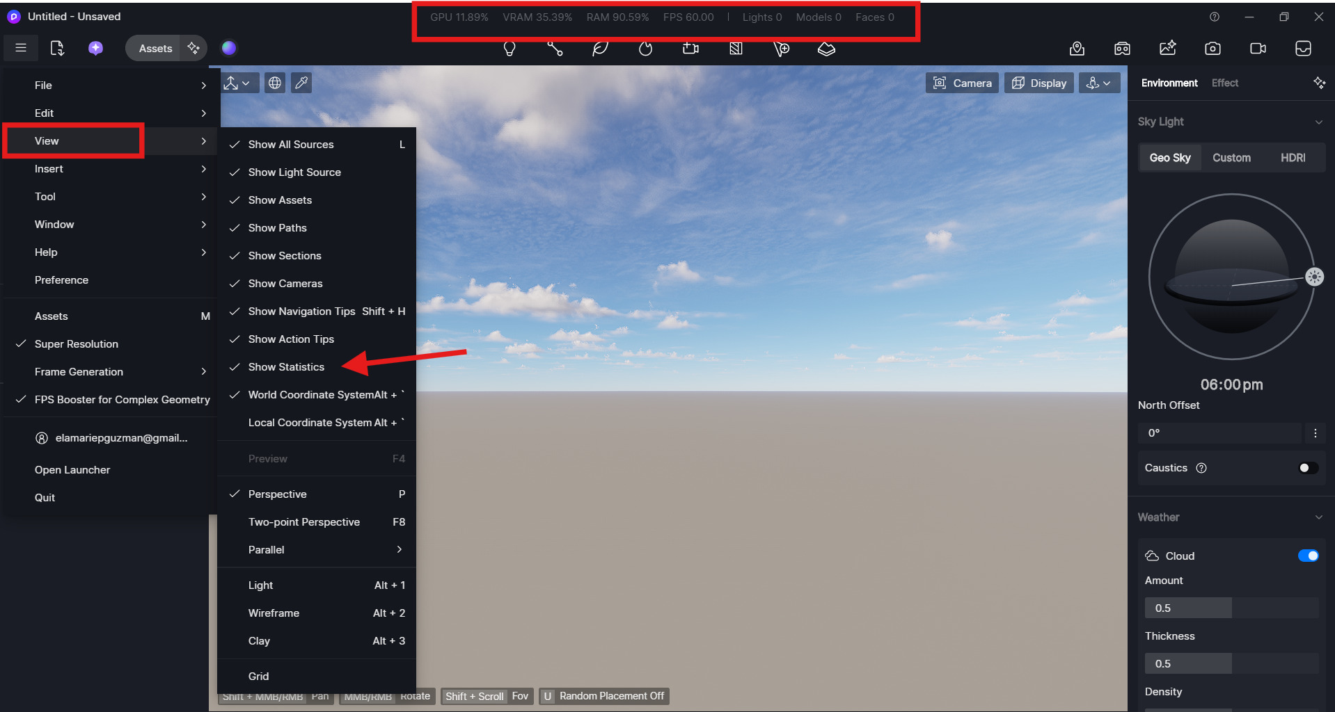

Sorry for the inconvenience. Long render times usually happen when the scene is too heavy, extra passes are on, or the GPU/driver isn’t running properly.
You can try a simple or demo scene to compare—if that renders fast, the issue is likely in your project. Check if your scene has high-poly models, lots of vegetation, big textures, or heavy reflections.
And it helps to open D5’s performance monitor to see if your GPU, VRAM, and RAM are actually being used. You can enable it in Menu > View > Show Statistics
