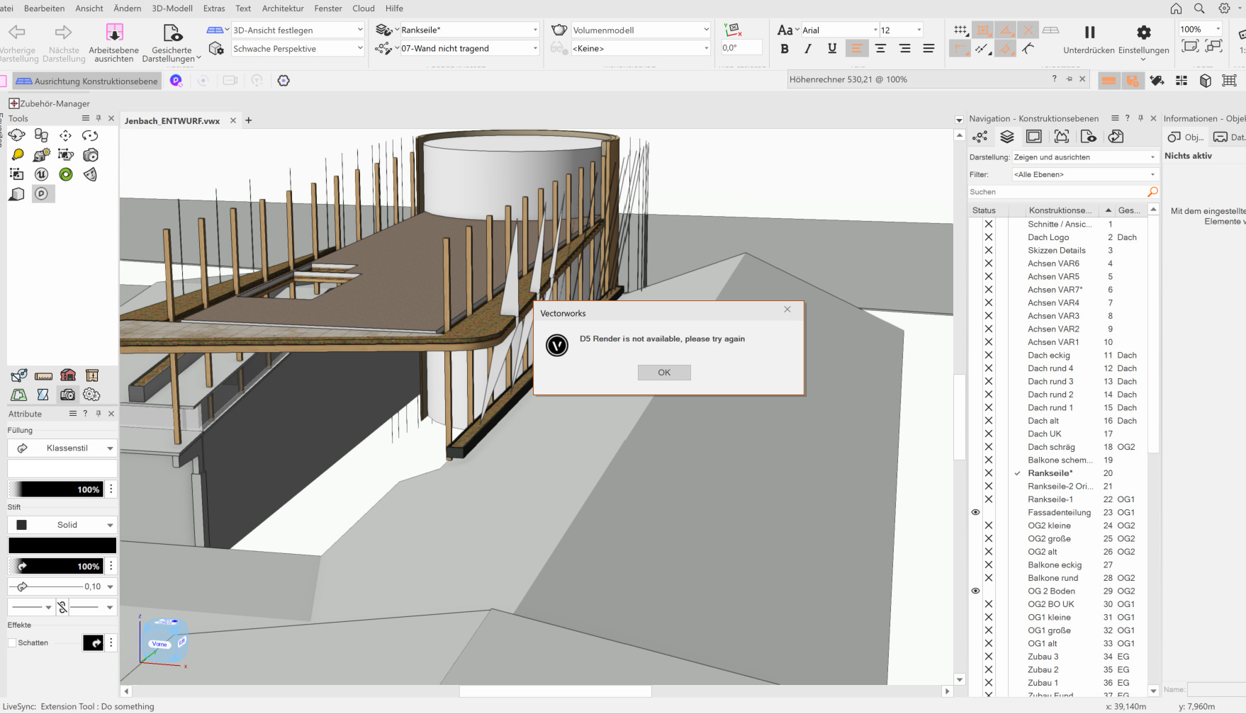

Hello,

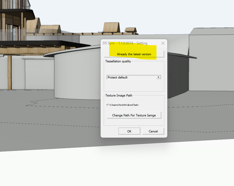

unfortunately D5 is saying “D5 is not available, please try later” after installation.
I use Vectorworks 2025 with Windows 11.
I have already tried uninstalling and reinstalled everything…
What can i do?
Thanks

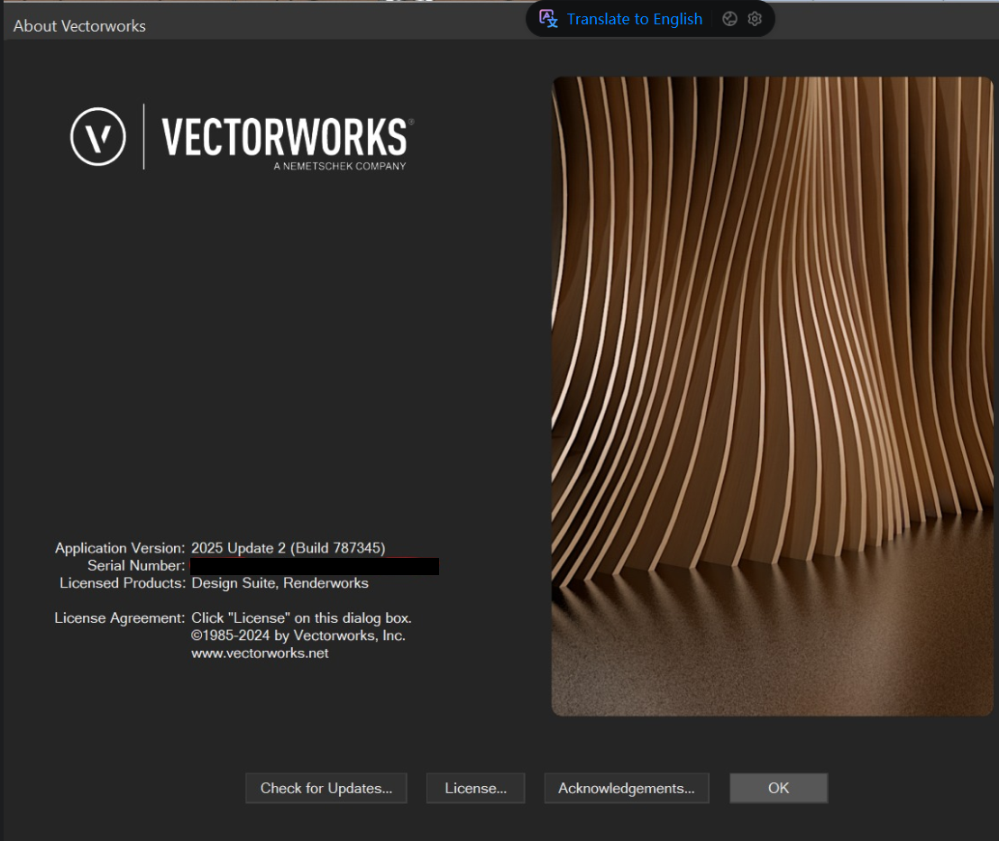

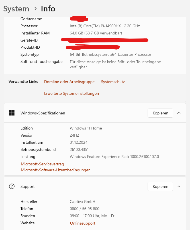

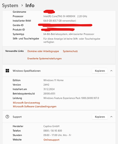

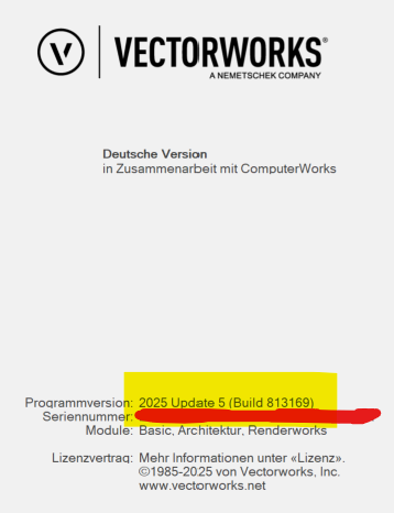

Hi @holzbein.design
I apologize for the inconvenience. Can you please share the following:
Hello.
Unfortunatelly i cannot find zhe menu of your first Screenshot… If its really important, please give me a hint.

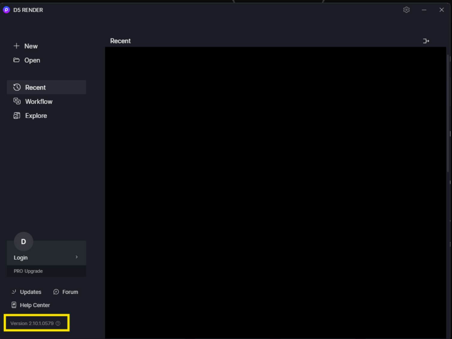

Hi @holzbein.design

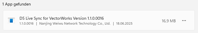

It’s a screenshot of your D5 Render Welcome Page. We would like to know which version you are currently running, since the VW plug-in only supports D5 Version 2.7 and above.

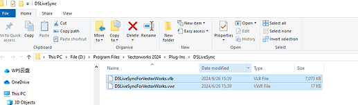

Have you tried reinstalling the Plug-in completely? Please follow these steps:
  1. Search for D5LiveSyncForVectorWorks.vlb and D5LiveSyncForVectorWorks.vwr in your local directory.
  2. Delete these files.
  3. Then reinstall the plug-in
Let me know if this helps. Thank you.

Hi @holzbein.design
Simply open your D5 Render application.
Hi again,
i dont have any application, thats the problem. I have just the Plugin on Vectorworks.
Hi @holzbein.design
Oh, I was assuming that you had D5 Render. Since D5 Render Plug-in is only a means of connection between the two software. You cannot use D5 when you are only using the plug-in; you need to install the software itself.

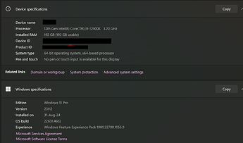

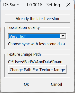

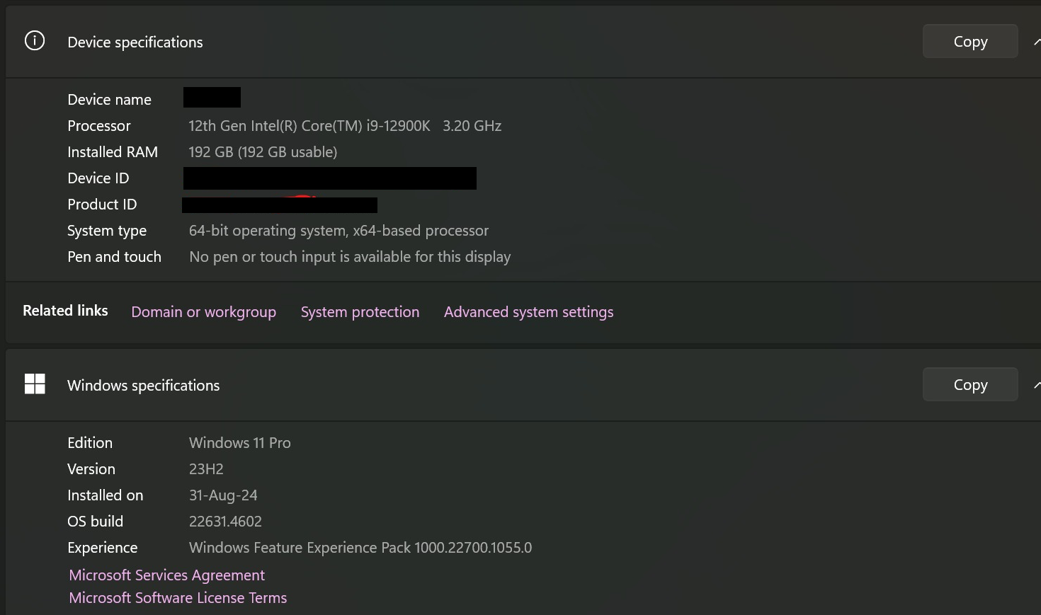

I have the same problem and tried deleting the files and reinstalled, but no luck so far, please help!
VW 2026
