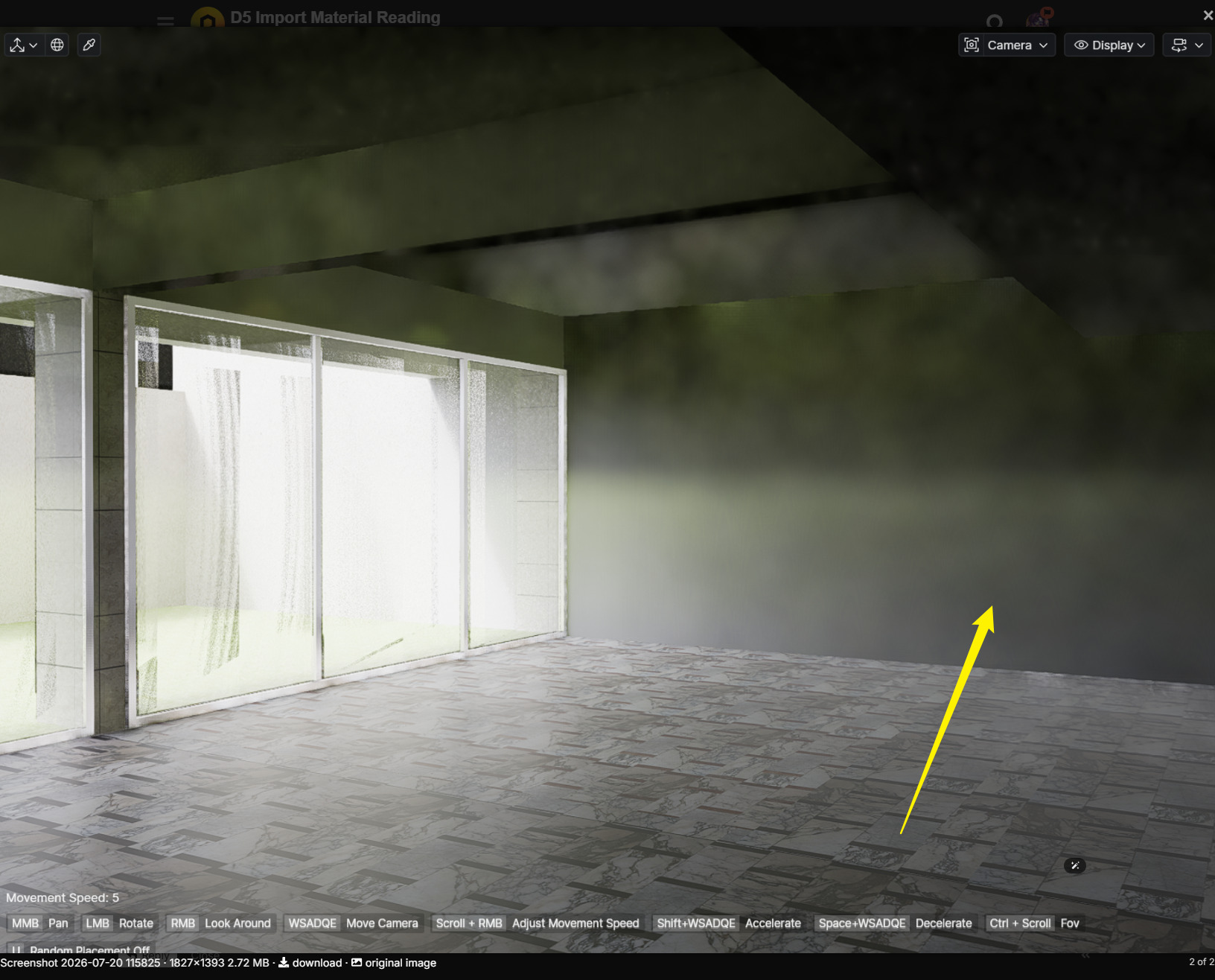

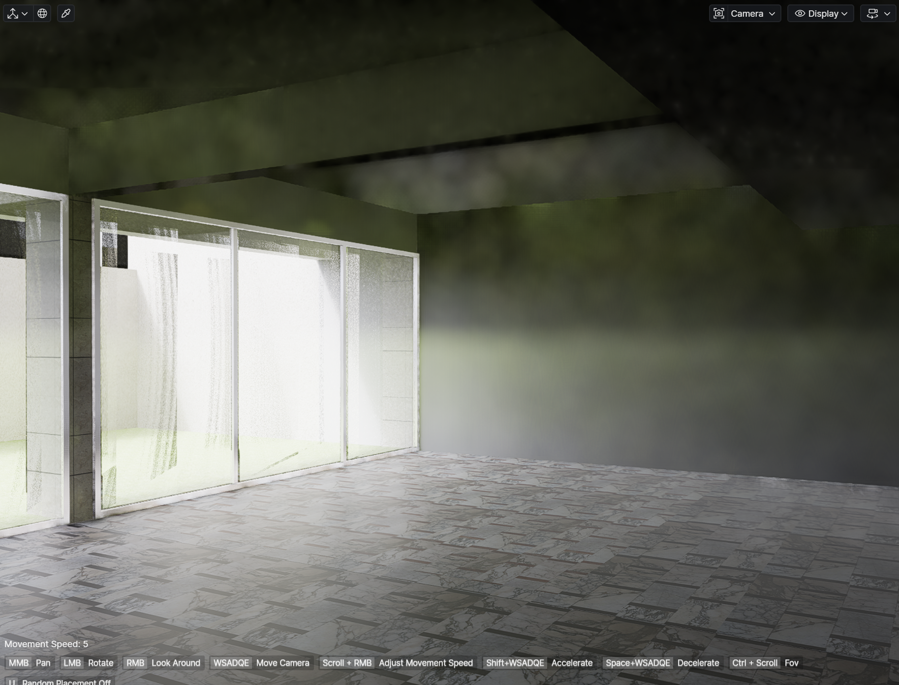

Hi! I synced my SketchUp file to D5 and my model opened up flickering and reflecting weird light and colors. I tried to play with the settings in an attempt to resolve the issue, but nothing worked. What is the reason for this, and what can I do? (My other sketchup to D5 files sync and work perfectly fine).
Hi @melodymbsg
Can you describe the flickering behavior? Could you send us a video recording along with your SKP and D5 File so we can take a look on our end?
  • The wall texture seems to have been overscaled; have you tried activating tri-planar or perhaps adjusting its size?
  • As for the light sources, did you enable “Cast Shadow”? Try to disable it and see the results.
Could it be insufficient indoor lighting? Try adding artificial light sources
It indeed was imported and scaled incorrectly! Thank you for noticing!
