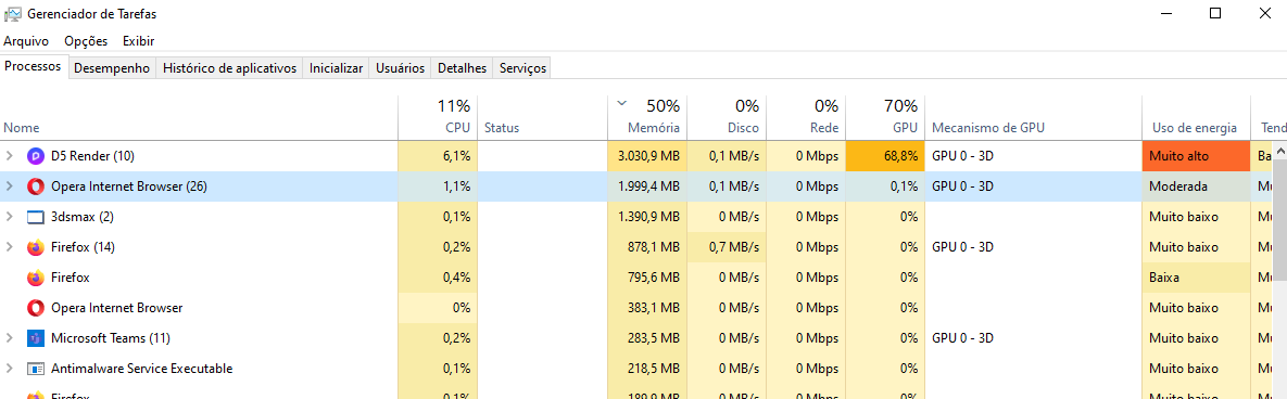

D5 hangs, cant do anything for 10 minutes
Hi guys

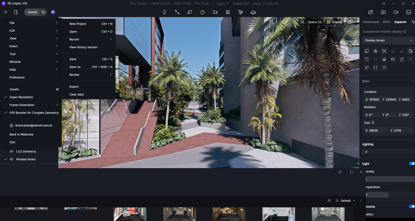

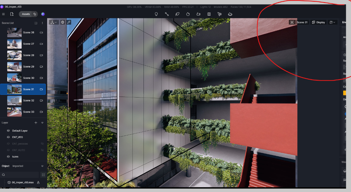

Im having a problem where d5 hangs and i cannot do anything, the screen bugs to something like this
its been happening for the last year on all projects.
after about 10, 15 minutes the file returns to normal, but it happens 5 - 6 times a day, even with smaller and lighter files

ill try recording next time it happens, but i dont know how to do it

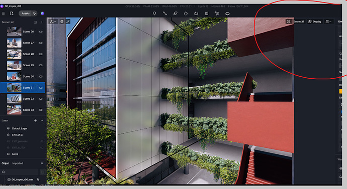

happened again, the ui gets strange
i dont how to record my screen… The files keeps like this and i cant do anything, not even saving or move through the viewport
after 10 minutes, it returned to normal but it happens 5, 6 times a day

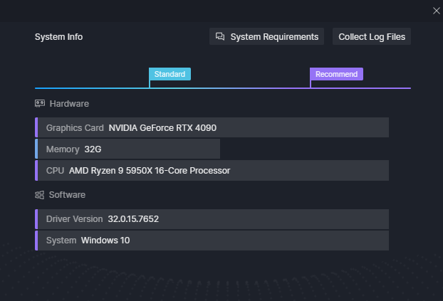

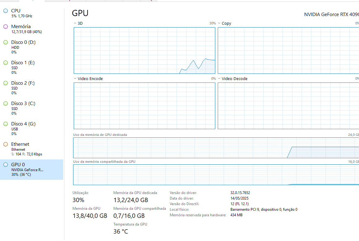

hi @Clov
ive been having this problem for at least 1 year, i had those drivers you mencioned (572.83) but it happened again (it happened on my last 10 - 15 projects).

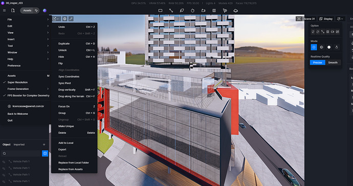

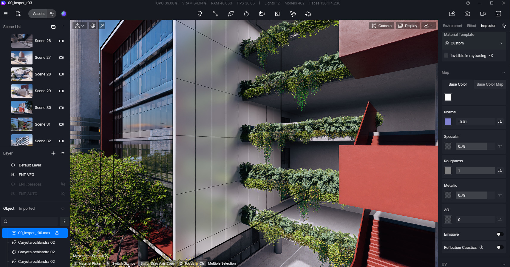

happened again, the ui is stuck like this,
cant click on any button or option
i recorded a moment when this happend, on the video the ui is missing i dont know why, but its was there. But i wasnt able to click any of them, while the file was hang up… the only thing ai was able to move ( cant select anything aswell) was the viewport, which was stuttering

Thanks for providing the video, but we may need to have you record it again with the UI being seen. I suggest using Bandicam and enabling Mouse Pointer and Keystroke, so we will be able to know which keys were pressed.
Additionally, just to reconfirm, this issue is evident even on empty files? Or Demo-scene files?

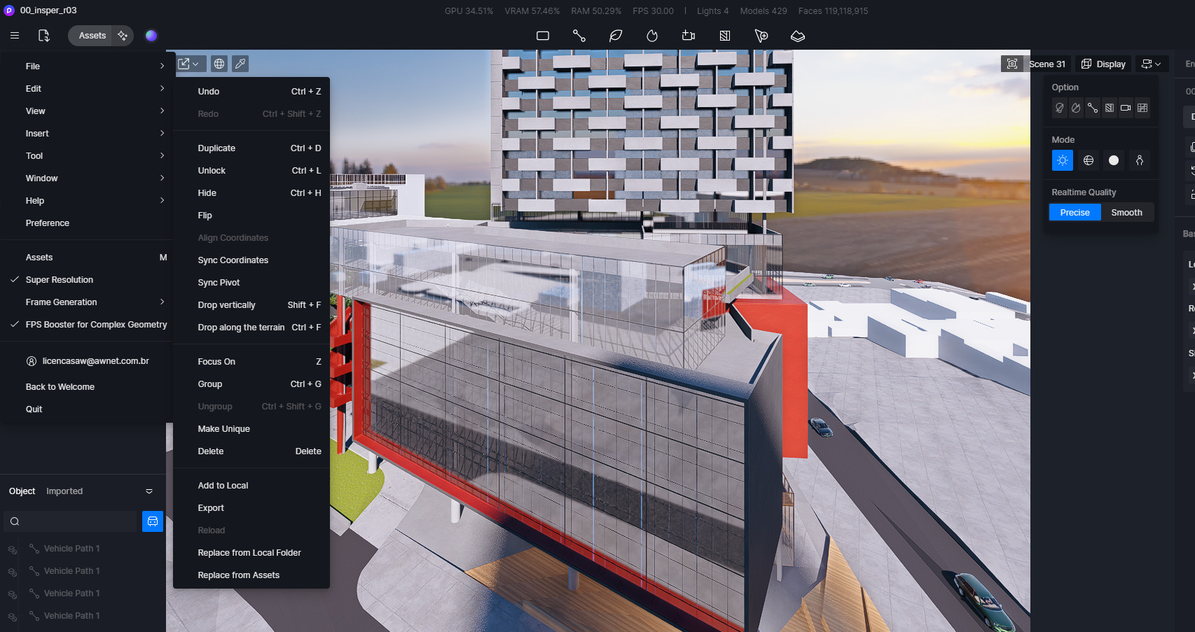

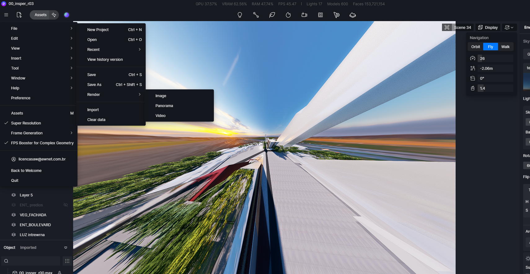

the ui is stuck again in this video, cant save and the viewport, while still moving, is very sttutery ( on normal use its smooth at 120fps)
Hi @NOG_the_DOG
Alright, thanks for sending the video, it’s clear as day~
We may need to report this issue, and we need your Log files and your D5 file (although this occurs to all of your projects)
