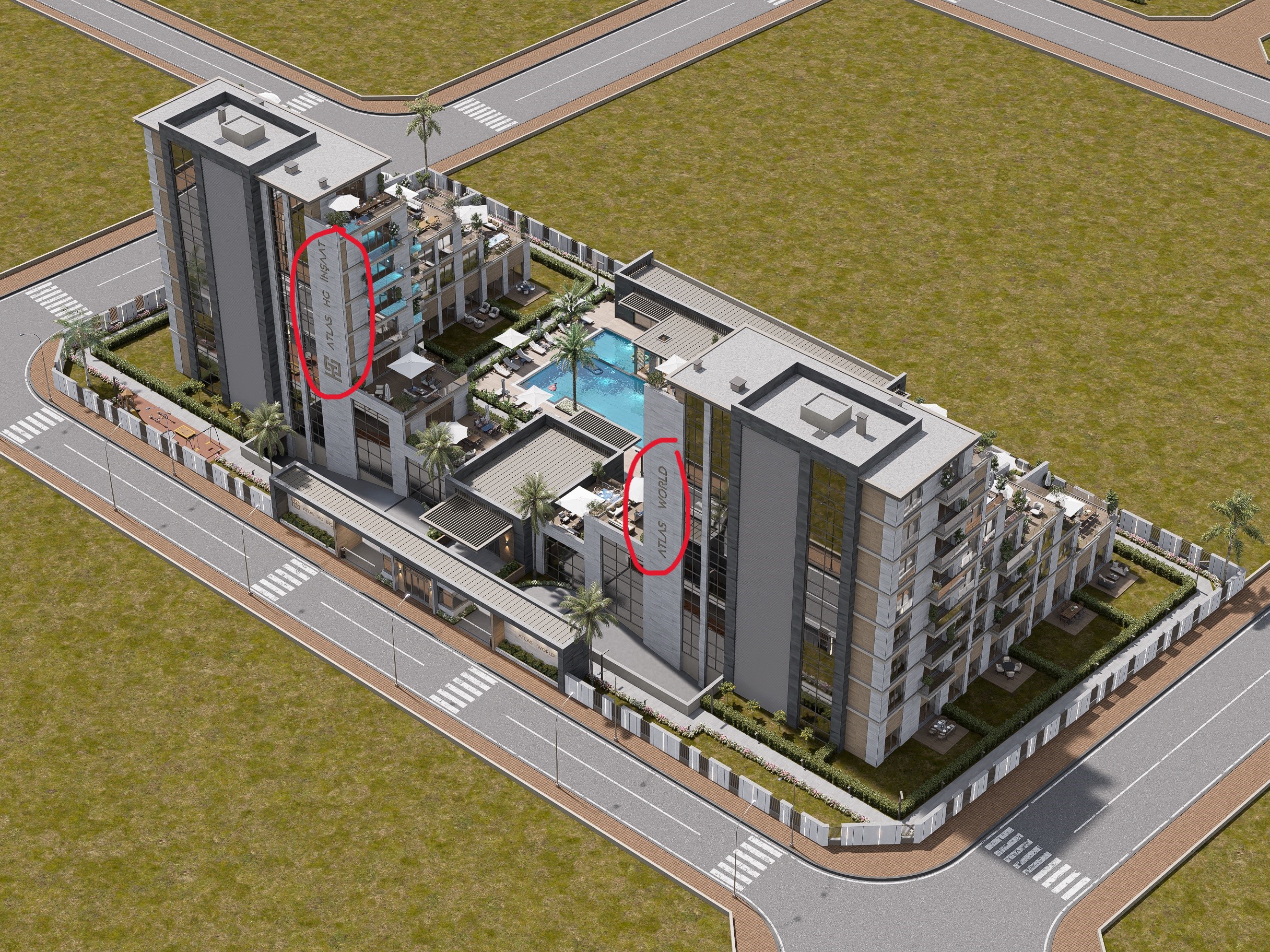

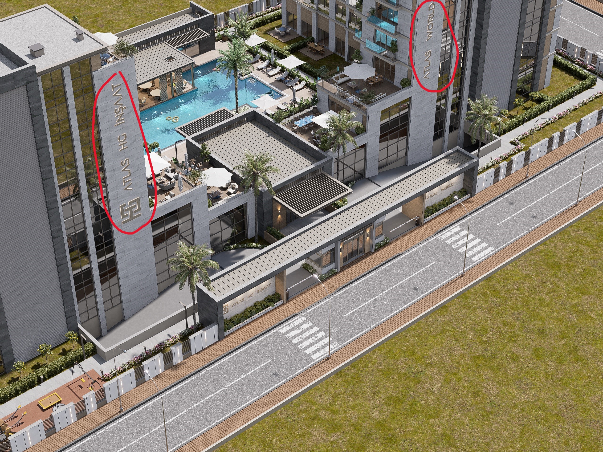

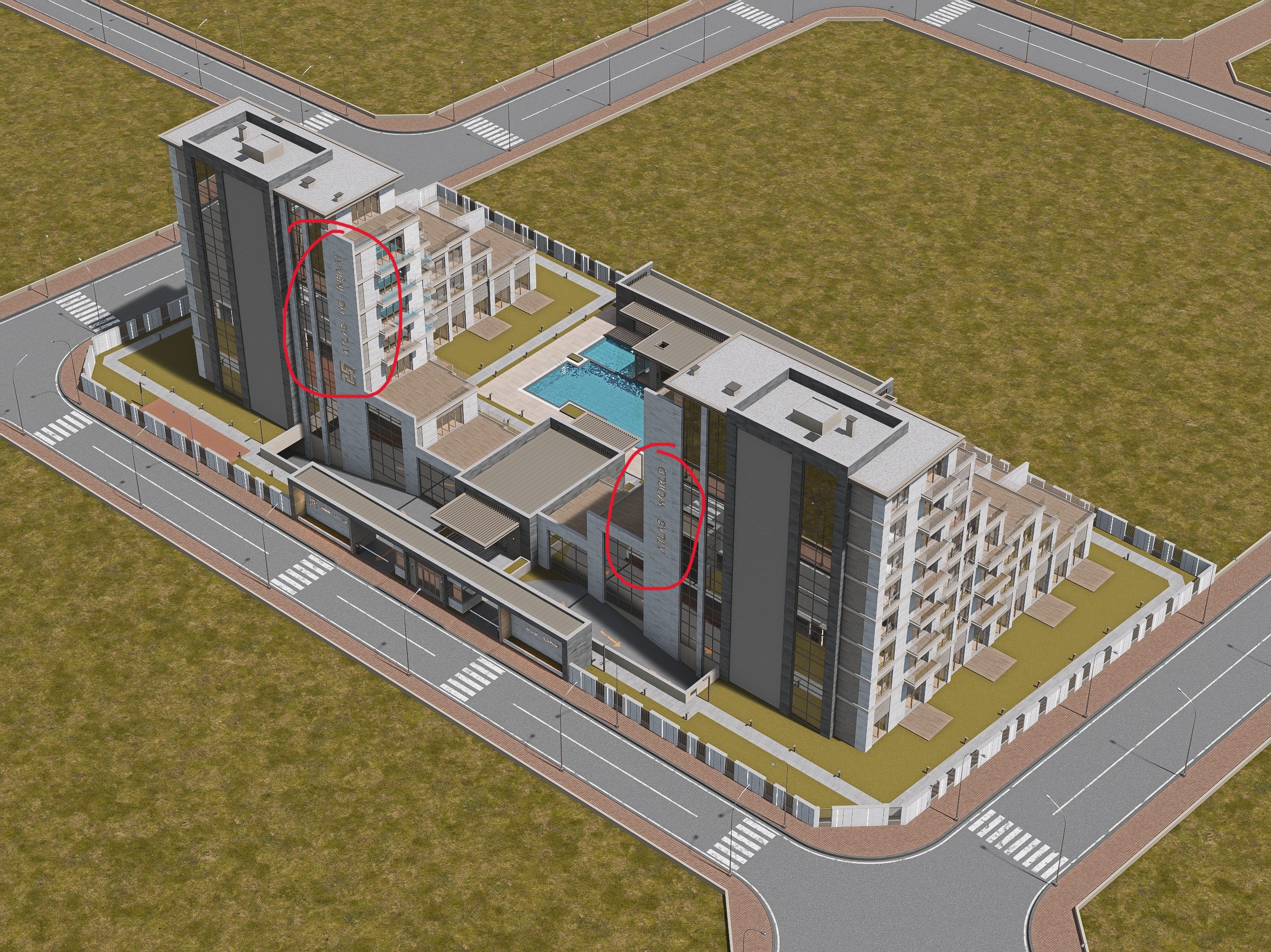

After rendering, the diffuse light effect I used in the texts does not work. It does not become active in long-distance renderings, we can see the emissive lights active after a certain distance. I also need to see the hidden LED lights behind the text from a long distance. Now I am sending you 2 different renderings and you will understand better what I am talking about.

I apologize for the inconvenience. Can you reupload the first image, it does not load properly so I can check both images.
Sure ! I will re-upload right now.

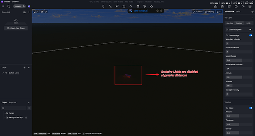

I tried to replicate it on my end with the Emissive Intensity at Maximum

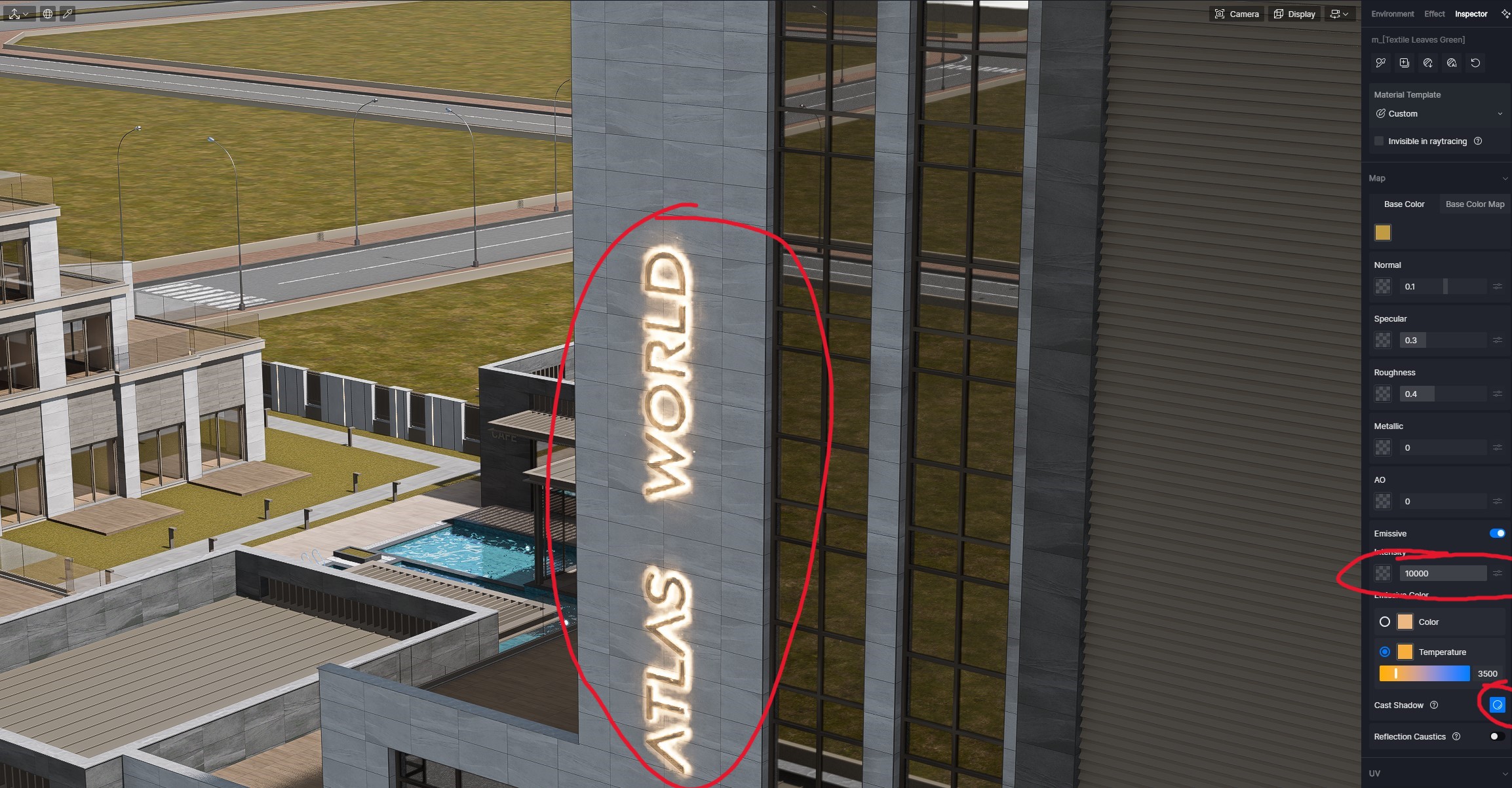

My emissive density was 100, I increased it to 10000. Still no result, no effective text backlighting. It should work successfully with 100 without having to do this. Because for those who use Render Queue, doing this will be a waste of time, a special render will be made for this scene. But as I said, even though I increased it to a very high density, the result is bad in the long-range render.
This render is a 2k render.

Our team has managed to pinpoint the issue, thus, it is a known limitation of backlit displays (emissive planes/material and even existing light assets), particularly when observing fine details or small light sources from a significant distance.
- For now, there is no workaround but rest assured that our team has already marked this issue as a known issue which may be addressed in future releases.
