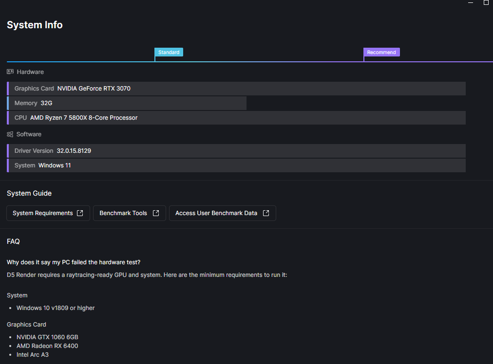

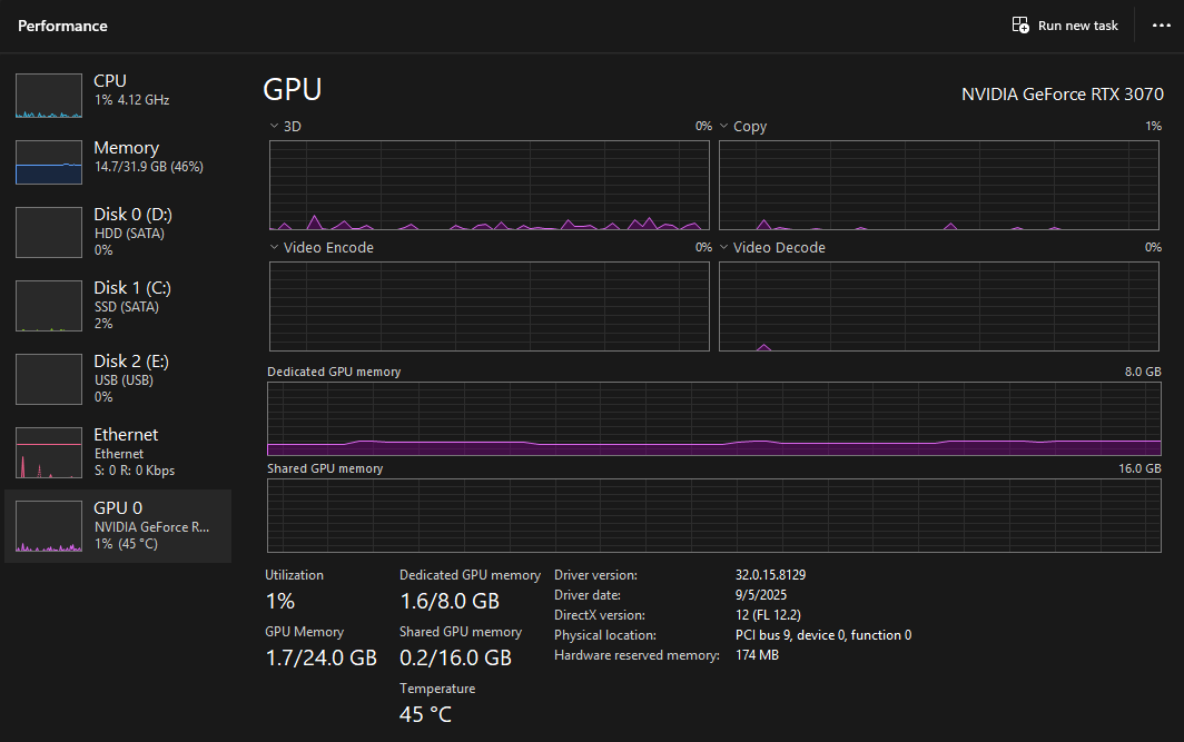

Hello, i have an issue that persists for more than a year. D5 does not get past initializing, Program Startup failed error or no error and closes.
It worked flawlessly i have different computers that still works but on this one witch is more powerfull does not…
Windows 11 Pro, V.10.0.26200
CPU: AMD Ryzen 7 5800X 8-core
GPU: NVIDIA GeForce RTX 3070 8GB
DRIVER: Game Ready Driver 581.29 [Tried with 610.47 no luck]
RAM: 32 GB
Works with some drivers and windows updates, when something updates does not work anymore. I really like how it renders but i cannot work reliable if don’t have a certainty that i can deliver a project to a client. Please Help
