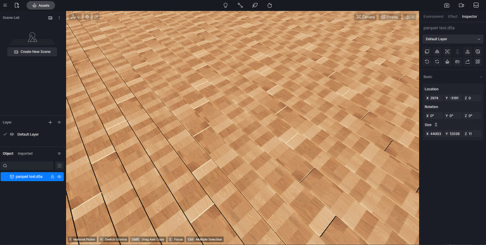

I just tried your workaround.
I generated a wood floor with the floorgenerator plugin. Than collapsed all of it to edit poly. The material used on it, is the corona multimap material.
And when I use the converter and open the imported file in D5. This is what I get:
Misoriented texture
Hi there, maybe the plugin is not compatible with D5. Could you try other method to create the floor and see if the texture is normal? And we’ll try the plugin as well. We will inform you of any further developments. Thanks!
