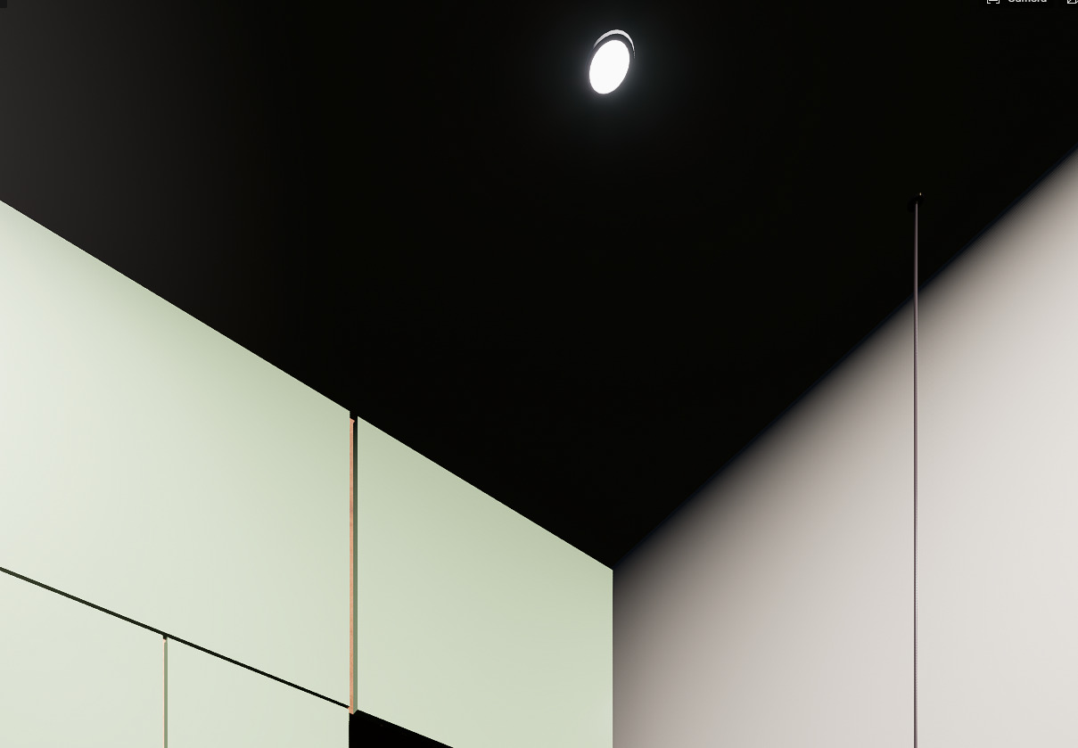

All of a sudden my D5 software viewport too bright
I have attached two files for your review:
  1. A screenshot of the current bright screen output.

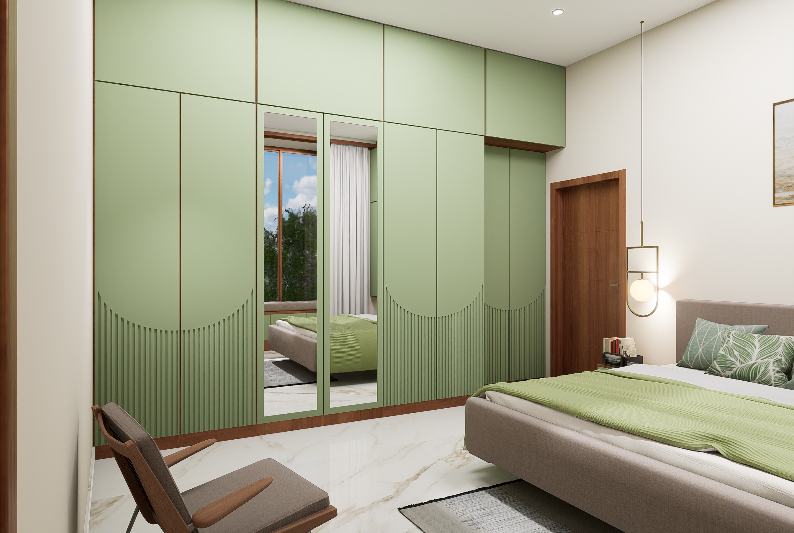

  2. The same scene rendered correctly just a few hours ago.
Could you please advise on how to resolve this issue? This is urgent.

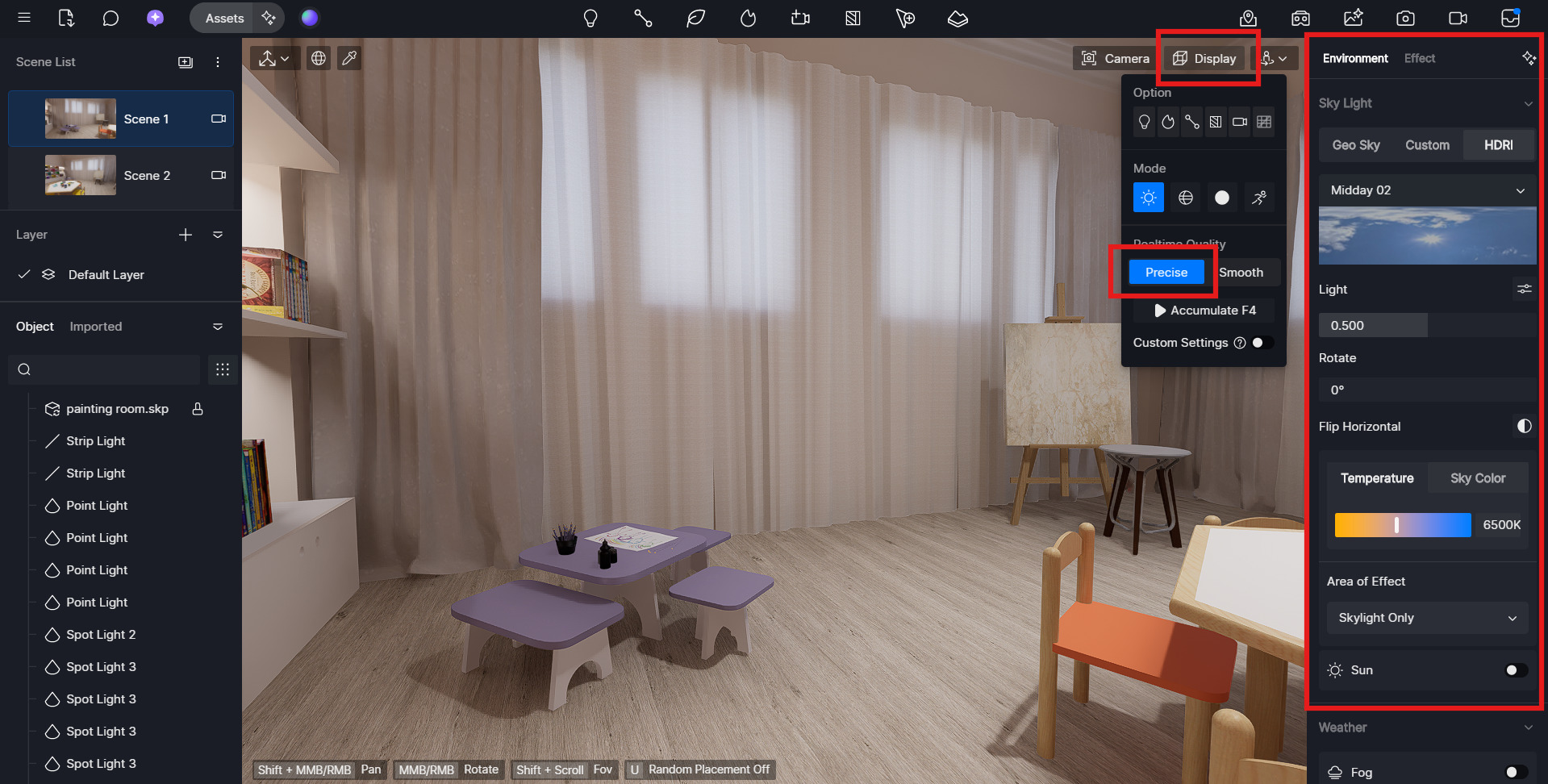

Hi @binu_alex
Please enable Precise Mode in the render preview so we can get an accurate lighting read and kindly share your current HDRI or environment settings as well, especially the HDRI you are using and its intensity value.
Also, please check if Auto Exposure is turned on. If it is, try turning it off and adjusting the exposure manually.
