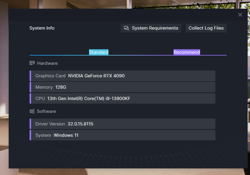

Your D5 client version and system info (accessible via D5 Launcher → Settings → System Info)

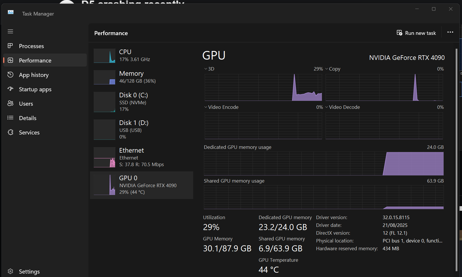

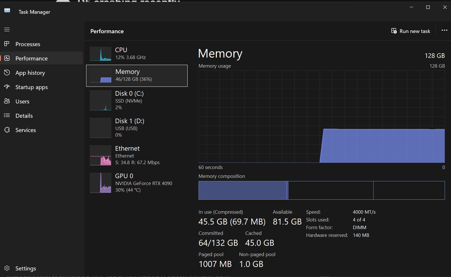

Your hardware details from Task Manager (CPU, GPU, RAM, VRAM usage)
Hi @kheng
Thanks for attaching the details. This may be caused by instability with the Intel Core i9-13900KF processor when running DX12 applications. It is recommended to update the BIOS to the latest version (released in April) or disable CPU overclocking, RAM XMP profile and Intel Turbo Boost/restore them to the default values.
