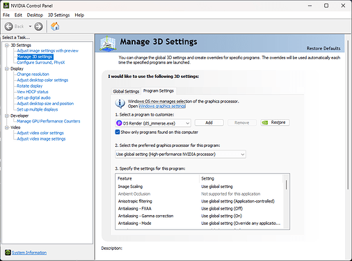

  • Can you check if D5 Render is using your Dedicated GPU?

  • D5 is using my Dedicated GPU (NVIDIA GeForce RTX 4070 Laptop GPU)
