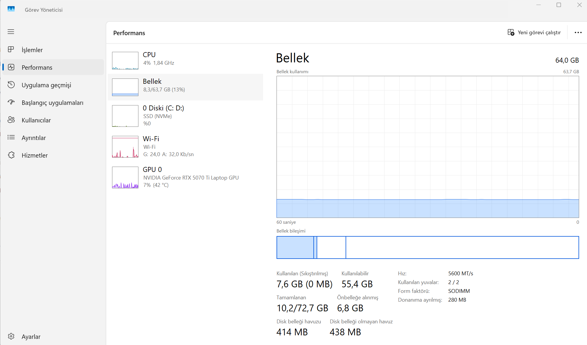

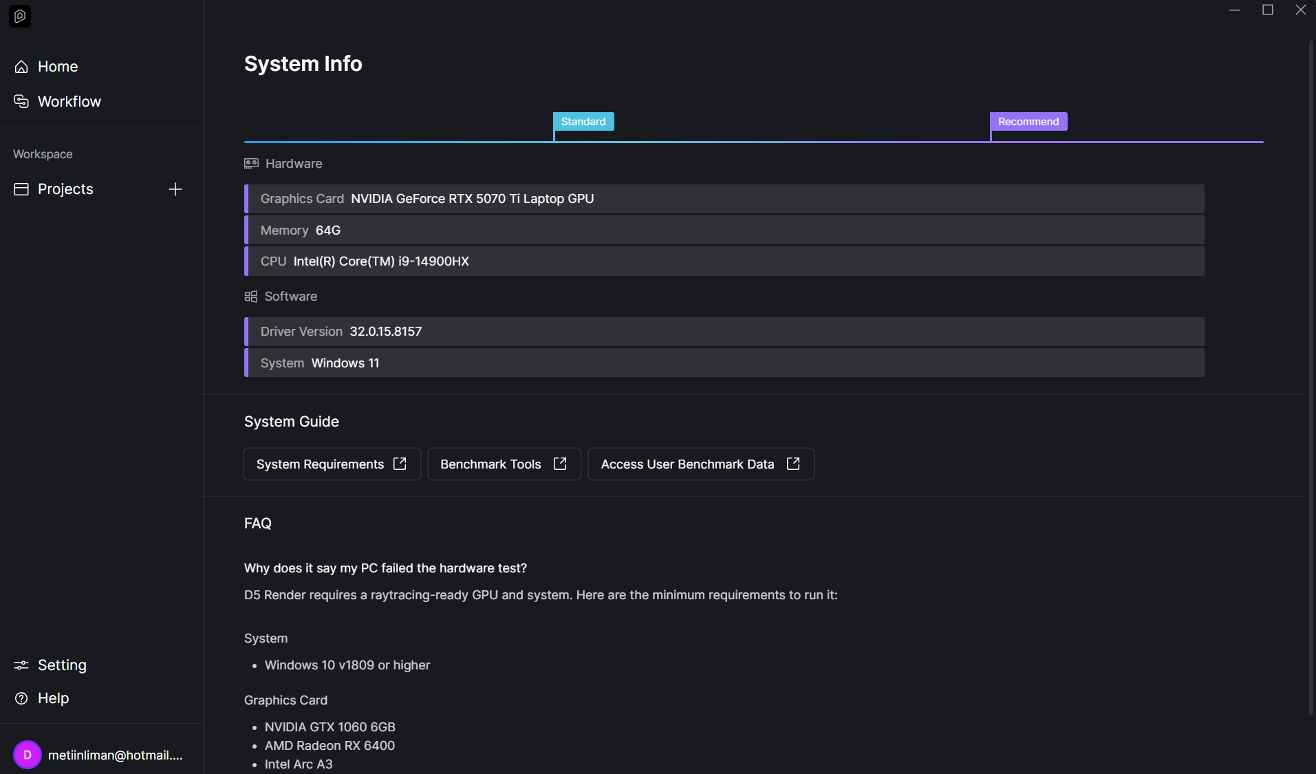

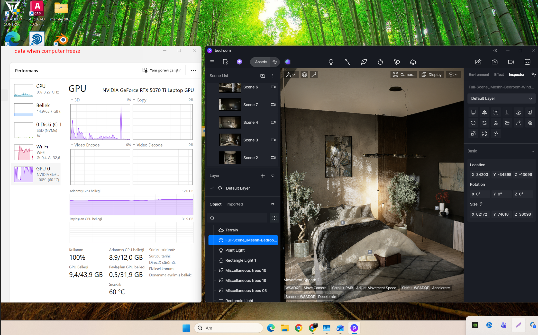

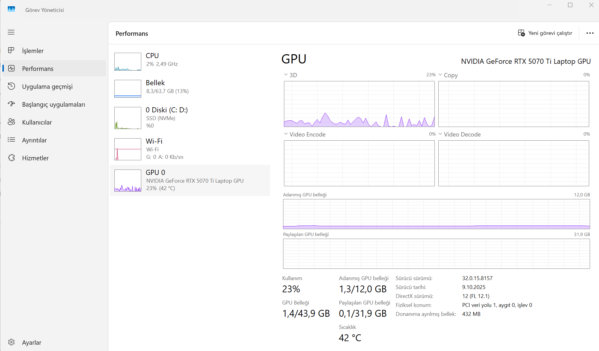

Hello, thank you very much for your reply. But it’s still not working — I’ve tried everything mentioned on the forum. Additionally, I’m sending the collected log files, and if you’d like, you can even connect to the computer remotely. We’ve set up a new system and are using it with six licenses. These ones aren’t working, and we’re really in a difficult situation. I’ve attached the screenshots, including the one showing the screen when the computer froze. I hope we can resolve this issue.
zziplog.zip (3.9 MB)
I forgot to mention that it closes in all files as well. I wanted to add that too.
