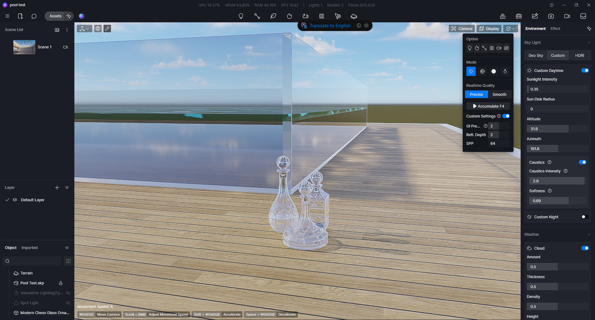

Please make sure to enable the following:
- If you’re only light source is the sunlight, please enable Sun Caustics.
- Enable Caustics for Water Material
- Enable Caustics for the Tile Material
This is the test on my end, I enabled Sun Caustics, Water Material Caustic, and other Materials that needs caustic.

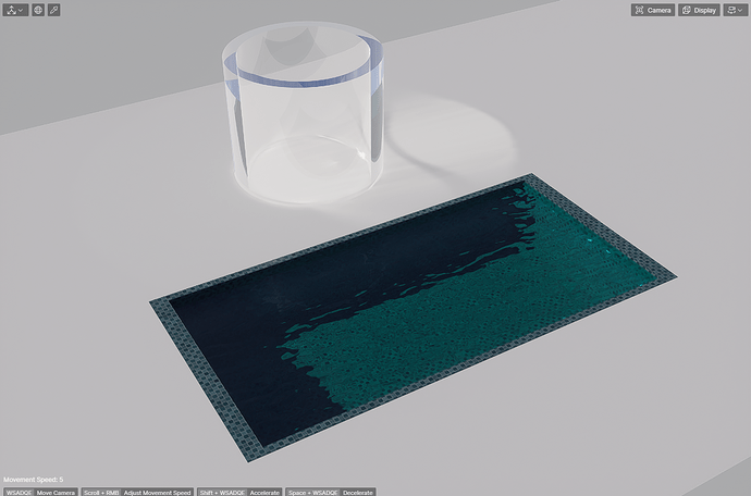

Hi, the caustics doesn’t work in the pool area, it works with glass but not shows inside pool with water, thanks

Hi clovisbolasco14, I think it works only with geo and sky, but it does not works with HDRI here are the screenshots
