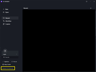

- Which D5 Render Version are you using, please send us a screenshot

- Same version as numbered in your screen shot
- Rhino 8 Live Sync. Same version as numbered in your screen shot

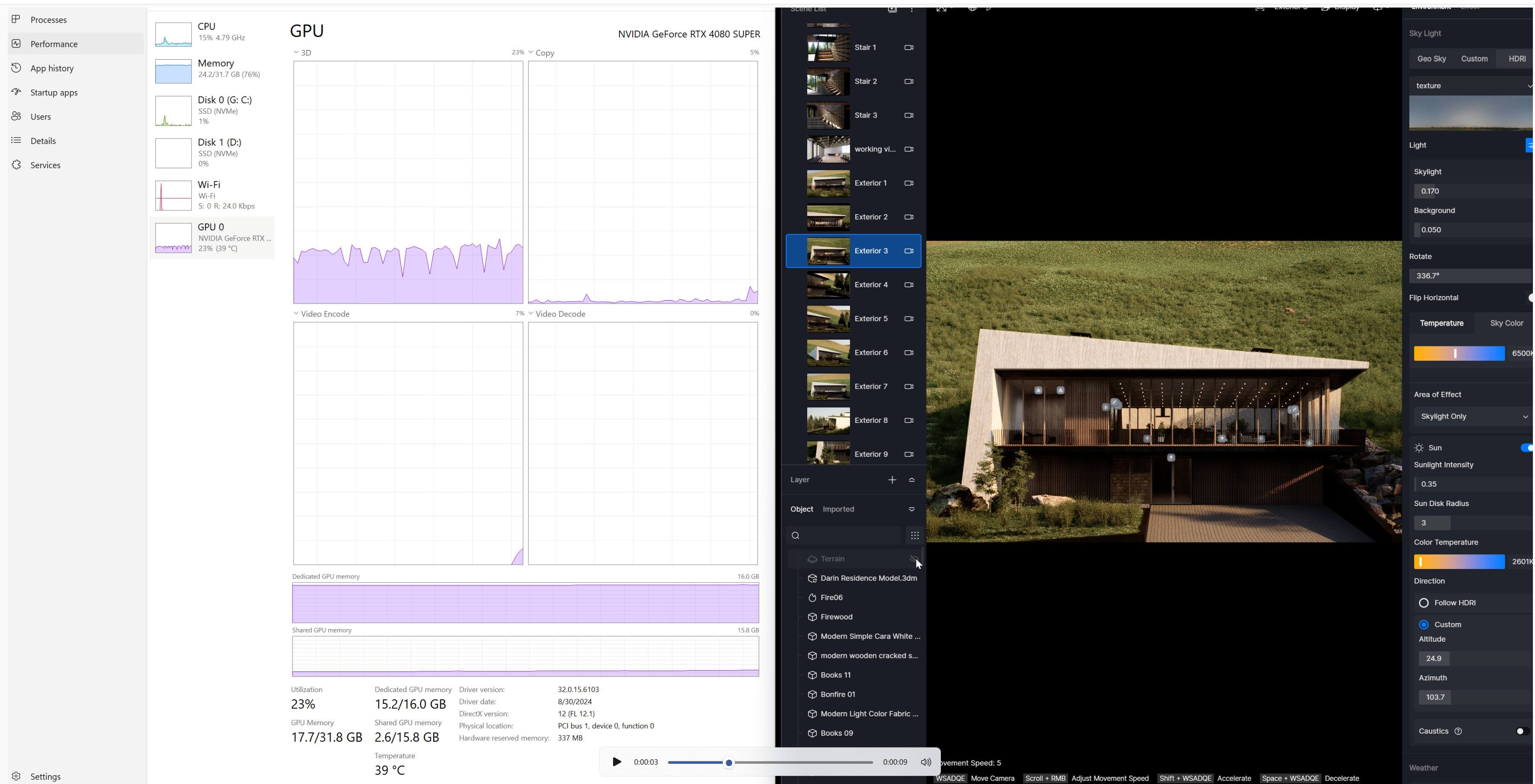

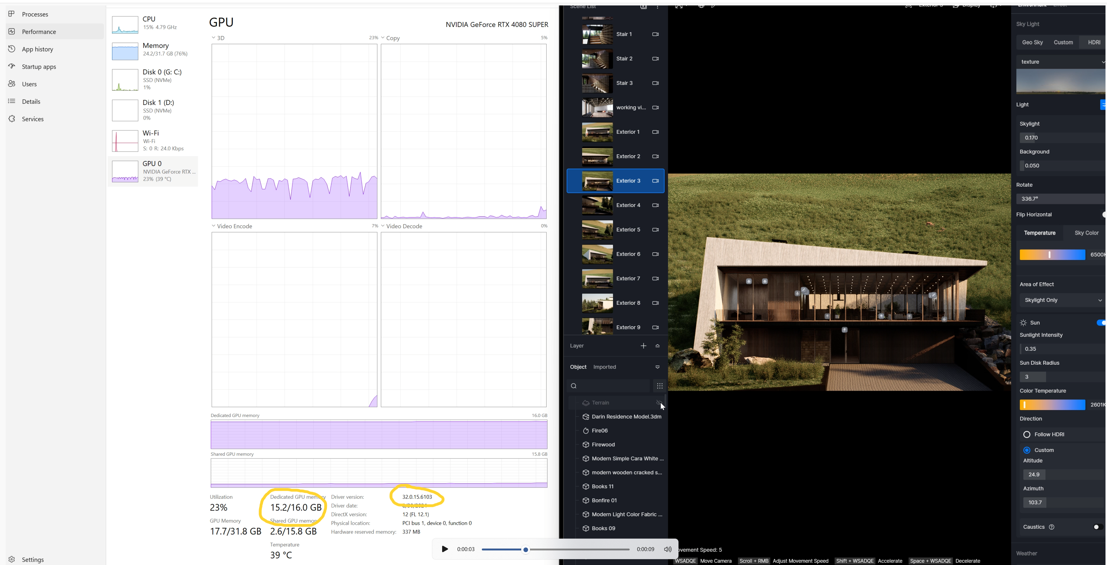

The first is with file open before clicking the terrain

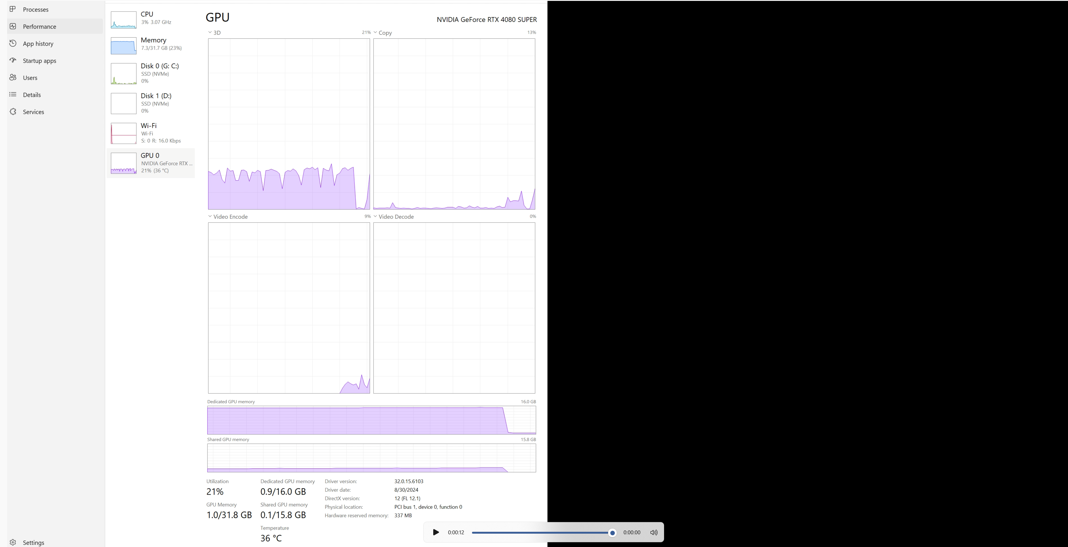

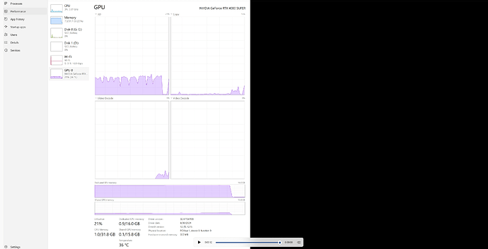

The second is after I clicked and the file crashed

Alright, thanks for sending us these images.
Update your Graphics Card Driver - Based on the screenshot you have provided, it seems that your device is still running an old NVIDIA Graphics Card Driver 561.03. Please update to NVIDIA 572.14 or simply avoid versions from 576.02 onwards since it has a lot of issues. And also ensure that you are using the Game-ready drivers.
Dedicated GPU Memory is at 15.6GB / 16GB - basically, the project is consuming a lot of your dedicated GPU Memory, which may be the cause of this issue. You may want to consider optimizing your file to reduce it or perhaps upgrade it. Although the upgrade may not be viable for now (it depends on your situation) but working with large files with a lot of scatter, you might want to consider this in the future.
