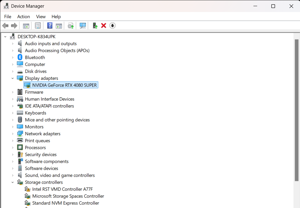

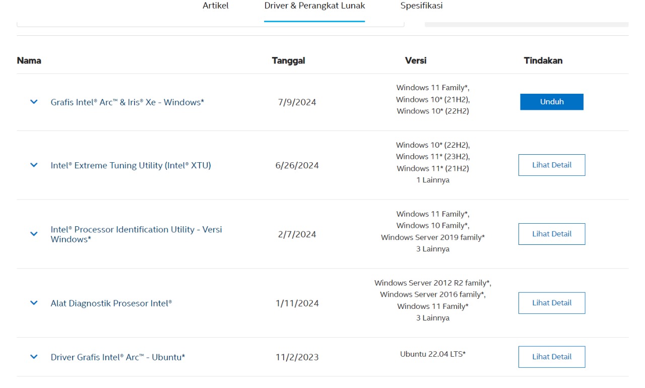

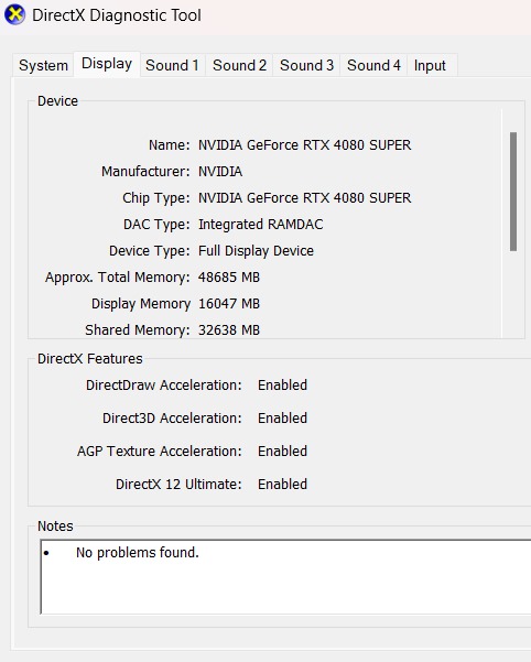

I have tried various methods and apparently I found that the Intel driver for the i9 14900KS in Windows 11 Pro (23H2 ver) is not available at this time.
Maybe this is the reason why I can’t open D5 which is based on the real time rendering engine. but with different case i opening up the Sketchup, and rendering with 3DMax Corona they still work properly. Only D5 cannot enter to the main UI after i press new project or even opening the last project. always get stuck at 99% and it will be force close or screen freezing.

DirectX intel Graphic not detected :
Device Manager only RTX showed and intel graphic not detected :
The websites from Intel :

The current 14900k(Series) graphics card may cause D5 to run unstable.
You can refer to these posts below, update BIOS or turn off the overclocking. Hope it can help you.
