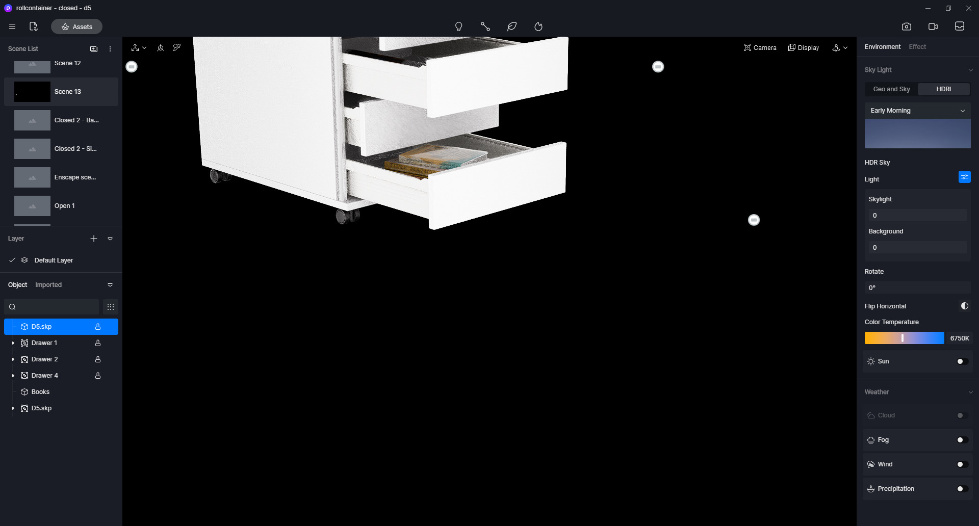

I am experiencing a problem with D5 + SketchUp. The cameras of SketchUp and D5 are way off from one another. The D5 camera doesn’t match the camera position I have set up in SketchUp. Please see the attached screenshots:
I have tried moving the 3D model in the SketchUp viewport to the model axes origin, restarting the programs, creating a brand new D5 file but the problem persists.

Hi mate, we cannot reproduce the issue you met, and regarding the FOV issue, it will be improved in 2.4.
Is the problem happen to all files or a specific one? D5 Render does not support photomatch, therefore, you can turn it off then try again. Also, what unit do you use for this skp model?
Hello Oliver, thank you for your reply. Apparently, what I had was some sort of bug. I created a brand new SketchUp file and started D5 from there and the camera position worked correctly.
