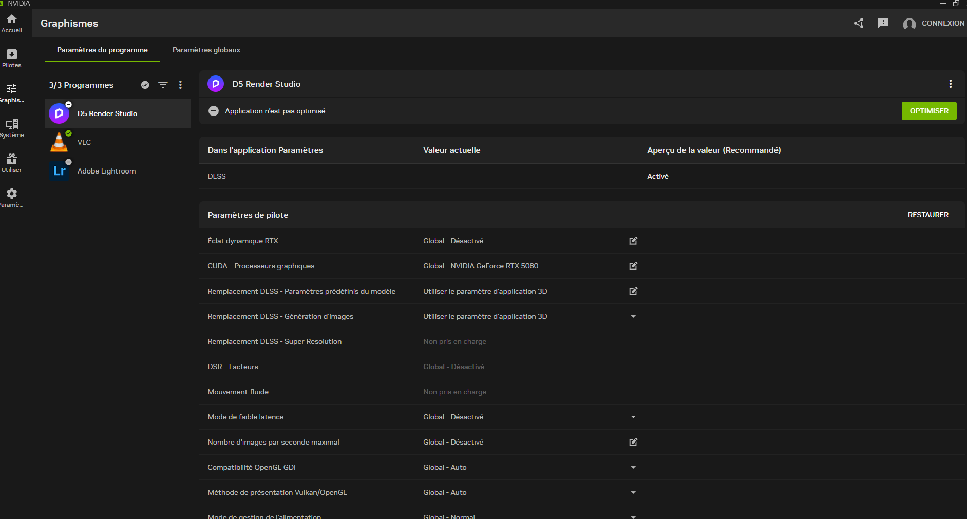

Hello. I have an RTX 5080 and I installed the NVIDIA App for the drivers.
I’d like to know if anyone knows which settings to use in the NVIDIA App? I feel like everything isn’t quite consistent.
- search the forum for the correct older driver. the most recent is not good for d5 render atm. this is mainly for the 50 series GPU
Hi @gwengosch
Please revert to version 572.83 since the versions starting from 576.02 onwards are causing trouble with the 5000 Series, and NVIDIA has yet to address it.
