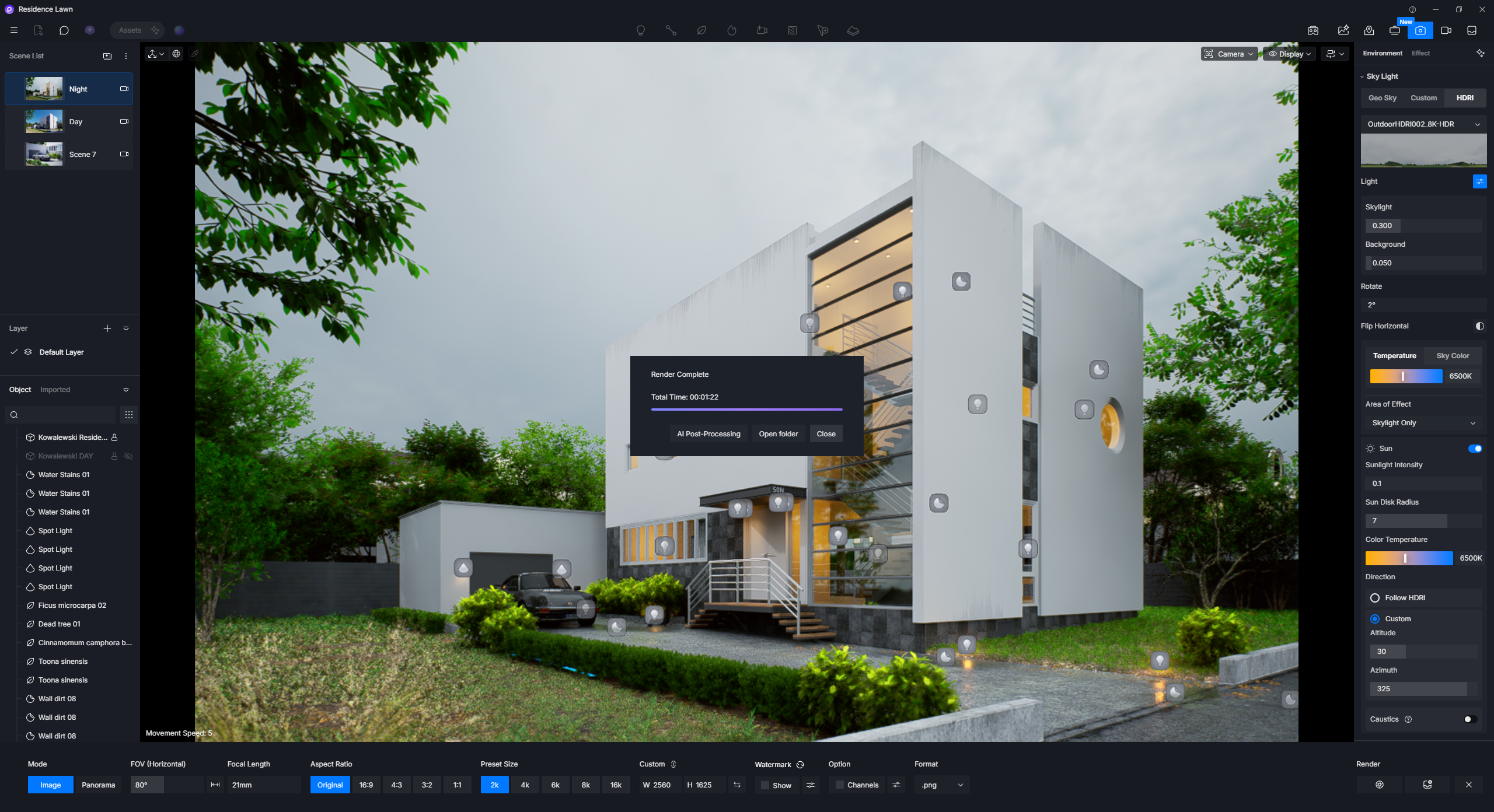

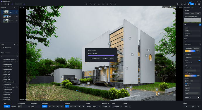

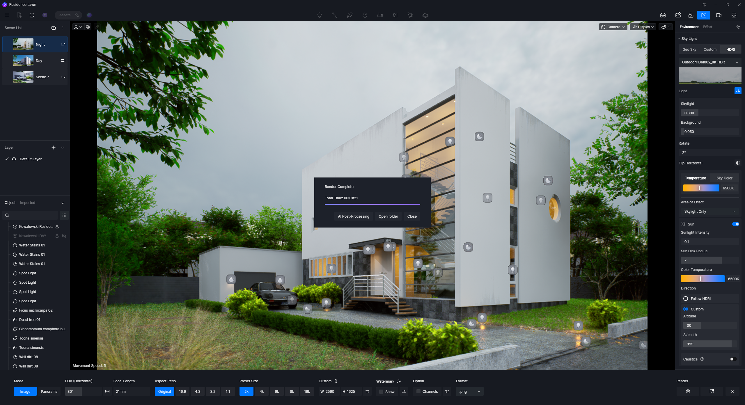

These are the results on my end:
I can confirm that there is a performance drop in version 3.1.

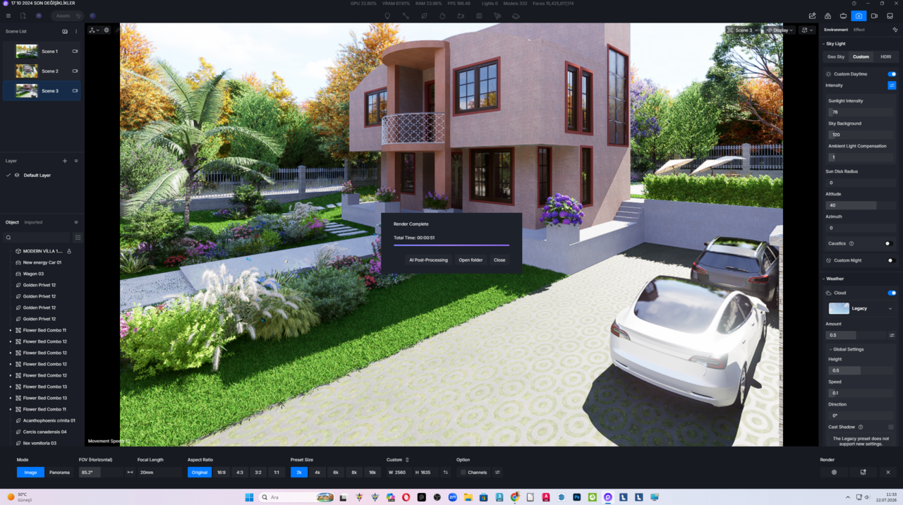

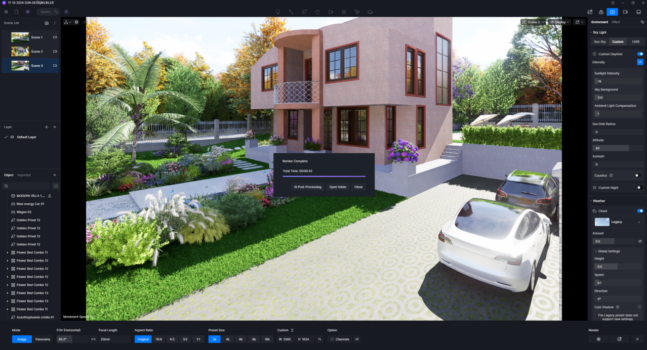

Hi @a.drexler
Please send us a rendering test to compare the rendering times of versions 3.1 and 3.0.1, or confirm if the issue is more related to the preview screen navigation.

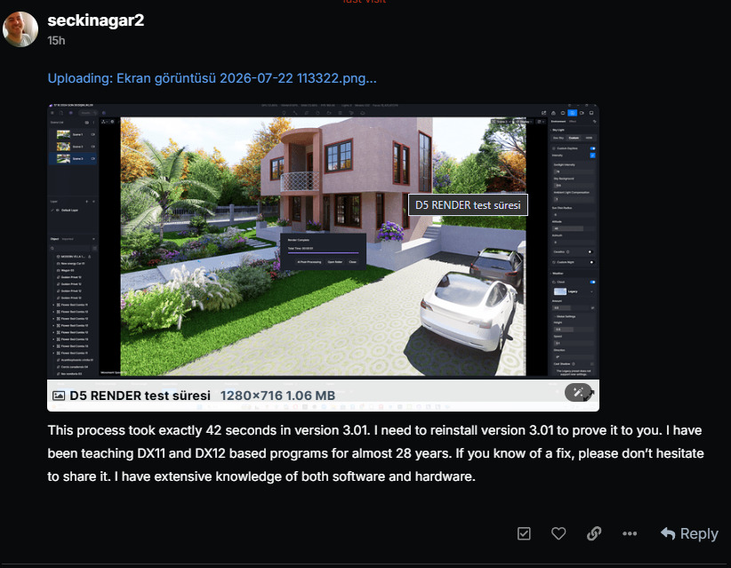

Uploading: Ekran görüntüsü 2026-07-22 113322.png…
This process took exactly 42 seconds in version 3.01. I need to reinstall version 3.01 to prove it to you. I have been teaching DX11 and DX12 based programs for almost 28 years. If you know of a fix, please don’t hesitate to share it. I have extensive knowledge of both software and hardware.
Hi @seckinagar2
Can you reupload the first image? It seems not to have loaded.
  • We’re currently collecting feedback for this specific issue, and we require screenshots showing the difference between 3.0.1 and 3.1 rendering time
  • Just to clarify, this issue occurred in all of your files and not just in this specific file, correct?
