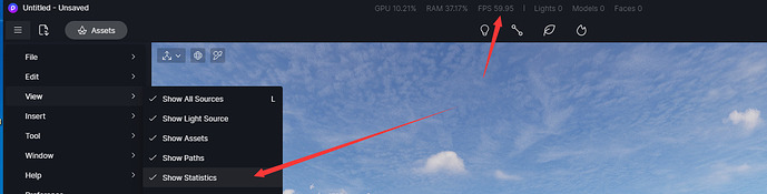

Thank you for posting. The problem happened to all files, or a specific one? And you can turn on this to monitor the FPS and RAM usage:
The second thing is that, your office Specs has only 16 GB RAM, which is not enough to handle large scenes as your home computer does. You can open our demo scene Living room, then check the FPS.
